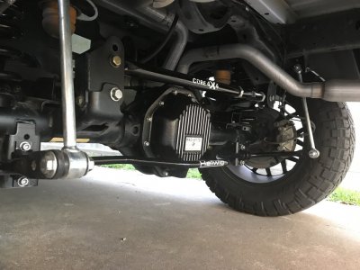

Ok here’s the deal, your really not going to a 4” lift you’ll still be a 6” lift.
For the front you need to set your Bilsteins to the stock bottom setting and keep the 5” top spacer. And reinstall, that’s it.
For the rear just remove the coil spacer you added and put the rear track bar down to the lower hole. I’m not sure what your rear bumpstops look like but refer to my pics below.
Last week I did the same thing to my truck as I just described to you above. My tires may be little taller/wider than yours but my front fenders are 43-1/2 front and 44–1/4” rear.

Ok, so I finally have some time to tackle this in the next couple weeks. So you are running the Bils at stock height with no preload spacer? And do you have the 3 or 5” rear coils?
