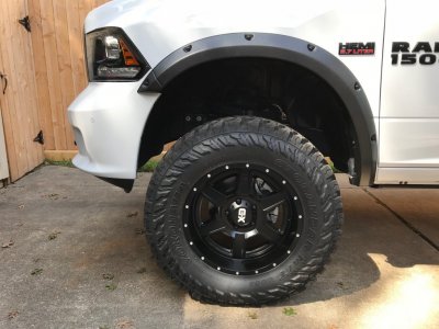

Nobody ever mentions this, but my tires did rub the front lower airdam bottom corner and had to be trimmed. There was no trimming required at the fender, it has plenty of room (inches). I added some rubber trim to the edge to make it look factory-ish.

^^looks great, congrats
So did you leave the Bils up and go with 5” coils?....looks like it from the pics
What’s the lift/tires/wheels specs?

Yes, Bils are set at 2.1 with 6/5 lift. 17" wheels 35x12x5, -12 offset. Gonna clean it up later, I'll get better pics an post up. Thanks again for all the help guys. Much appreciated.
