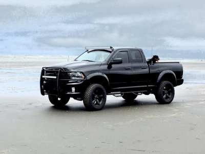

The stock wheels will fit with the lift and 35s, I ran this way while I waited on my spacers. Specs in my sig
