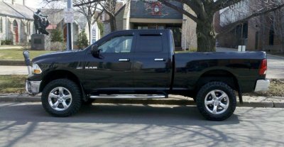

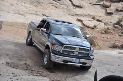

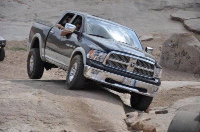

ok guys this is the story, I contacted Zone to ask them about there lift,
first I told them I have the 2011 RAM 1500 laramie 4WD but it comes with a 17*8.5 inch wheels stock ! I know it sound strange but this is how it comes to us in Saudi .
any how , about there 6" lift , I asked will my rims and tiers witch are 315/70/17 will be ok with there lift, they said they dont know and mostly it will not as something will hit something else I dont remmber realy but I can copy past the email if you guys like:)
so I asked again if I use an wheel adapter will help as am already using now .
also they said they dont know :crazy:
then I asked if the 4 inch will be ok ?
also they said they dont know :killer:
so in the end did any of you guys had a problem with any of your lift kits running 17 wheels ?
and these are some pic of my RAM hope you like it and you can see the kind of rims I have .
:peace:

Great looking truck welcome! You should beable to clear those tires with their 6" lift. Your tires are roughly 34.5" tall. You should have no problem. Aslong your wheels don't have a huge -offset. If to have stock wheel your fine. Hopefully smoothies will chime in too

i don't think its the diameter of the wheels that they were sketchy about. I think it had to do with not knowing the offset/backspacing.

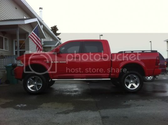

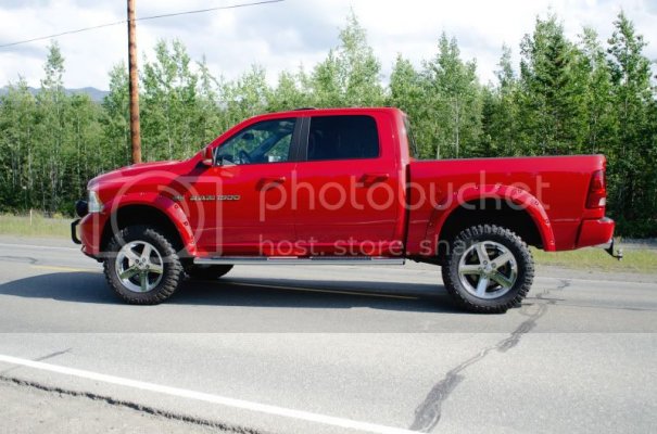

Thor is correct. The 17" wheel is the smallest that you can run with the lift. I have my stock 20" wheels currently on my zone kit and I added a 1/4' wheel spacer to make sure there was no rub. I think depending on how tall you want your truck and if you want the back to sit higher then the front you should go with the 6/5 lift.
Here is a picture of my 2011 Ram with the zone 6/5 kit installed. Notice the front was lower then the rear.
I did not like the rake look and I did not want the rear to sit lower so I installed bilestine 5100 adjustable shocks and set them to max to raise the front of my truck 8" so it would look level. Here is a picture with the bilestines.
If you want it leveled look without having to spend more on different shocks you might want to go with the 6/3 kit.
