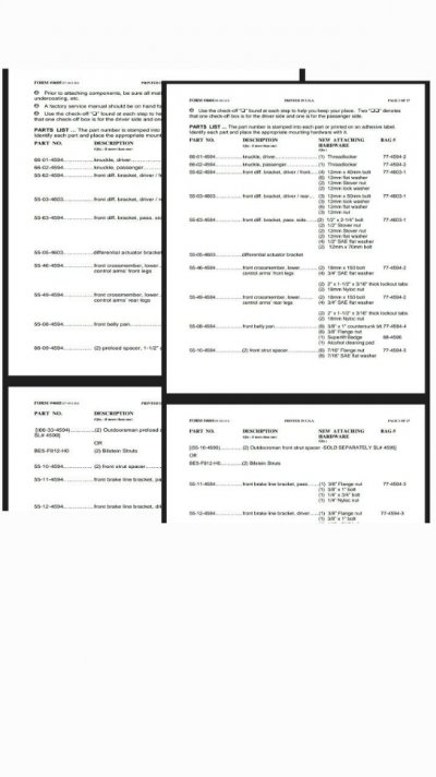

San Diego, Left Coast
4" and 6" kits are different, they have different drop brackets and knuckles.........otherwise the 6" lifts wouldn't have the cv's sitting level. This whole strut spacer thing, who cares? 6" kits require a strut spacer AND a preload shoved in the strut to gain 6" of lift, ALL brands require this.
Im not making this stuff up lol.
Here's superlifts part #s for the 4" and 6"... as you can see, the knuckles and drop brackets are not different.
Does zone do the same thing? .. I'm once again 99% sure they do.
