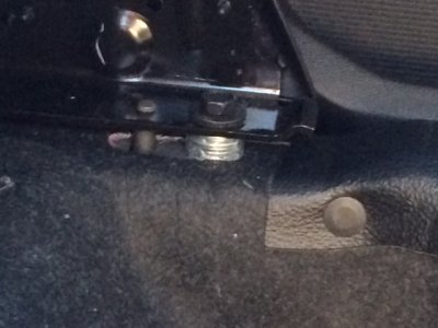

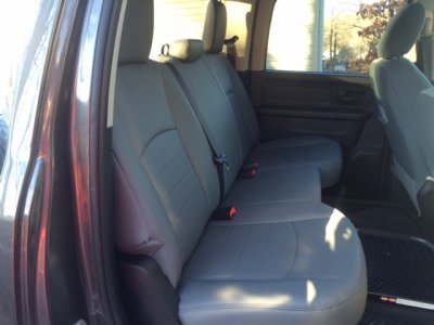

I did the rear seat mod today. Took all of 15 minutes and cost $5.00.
Started by loosening all 4 bolts holding the rear seat down. I left one in a couple of turns to keep the seat from sliding when I lifted it up.
Stacked up 7 1/2" washers to equal 5/8", and taped them together for easier handling.
Lifted one end of the seat and put a stack of washers under each bolt location. Started the bolts in that end, then did the same to the other end.
Tightened the bolts back up.
I have the full bench seat in the back so I only had to deal with 4 bolts. For the 60/40 bench you will need twice the amount of washers.
I still have full lock when the bottom of the seat is down. The locating studs are also long enough that they still go in place.
