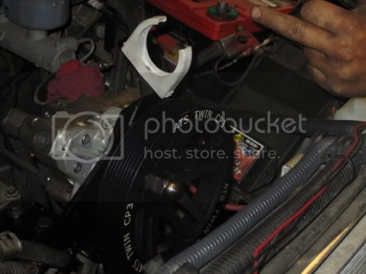

Did and started some installs today. Its been a lonnnnngggg day.
ATS Dual CPS kit(DB truck customs)
Mean Green Alt(DB truck customs)
AirDogII 165 with sump mod(DB truck customs)

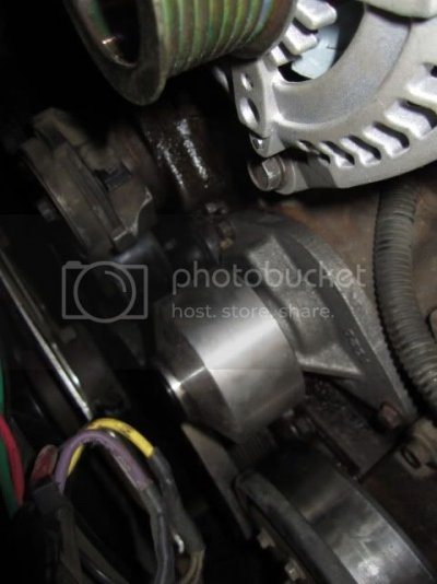

While I was at it noticed the water pump bearing was a little loose so got a new one($50 at NAPA!)
Then Noticed that the T-stat seal may have been leaking. Replaced that ($20 with new stat NAPA)
Got some of the CP3 install done. Getting these OEM fuel lines off is a HUGE PITA. And the ATS instructions kinda suck(not horrible but could be better).

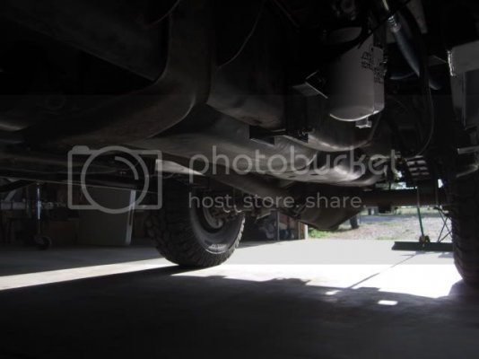

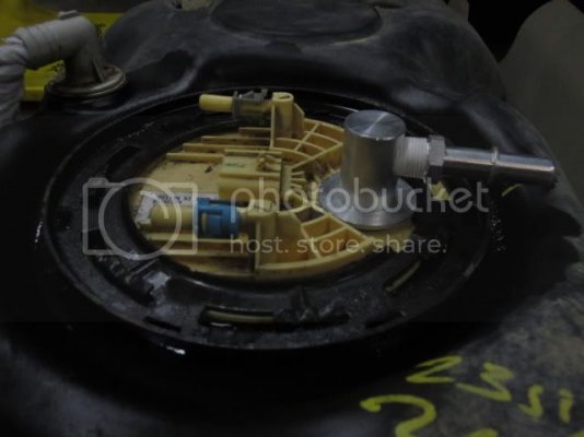

Got some of the AirDogII kit installed(waiting to finish the CP3 to finish the AirDog). The tank sump mod did not go as well as I hoped but it should all be alright.
Pics:
Mean Green
water pump
AirDogII
took the fins down on the sump
end result

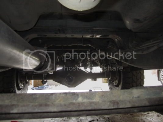

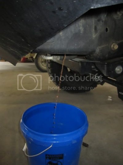

truck pee for CP3 install
tank out, so much fun
tons of room now....
CP3s(im getting there)
helper not so happy

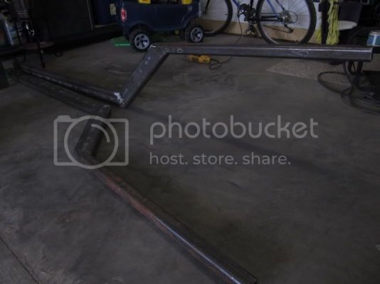

Helper little project. Built frame rails for his jeep XJ, going to be a half buggy.

I just want to say how nice it is to find the ONE cheap CTD part. The water pump! Still could not believe it was only $50. If I recall right my 98 360ci gas's water pump was like three times that.

Did you take it through where the alternator is? Or did you do what the general population says and through the radiator fan assy?

well two things. One is yeah I kept the alt out to help out but two I also have the efan so I had a bit more room. I may have been able to do it with the alt in but I dunno.

Yea, makes sense. I want to get an efan here sometime soon but we will see. I just took out the alternator and went through that way, it wasn't hard at all. Keep up the good work!

thanks but if I dont get it all in today im going to be piiiiiiiiiiiiiiiiiissed off. having issues with the fuel lines, and we lost a socket....... the entire new CP3 system has to come back out. and now im getting a late start.

Damn man that's super sweet! Air dog 165, twin CP3's...So i take it you plan on doing a big fat single or twins with 120+ HP sticks??
So what's the purpose of that sump kit? I have a FASS 150 that needs to go in and was figuring if that sump was necessary.

sump mod just allows the pump to pull more fuel and also keeps you from getting the 1/4 tank issue. And thanks, and ill start with a bigger single then slap a second one in at a later point. Im just getting the support mods done for now so have not decided on a turbo(s) or injectors yet. But I hope to go big. :)

tanks is back up. dident have the proper fitting to attach the lines on the engine side of the airdogII so ill be trying to get with airdog tomorrow and hope to finish it up next weekend. God I hope everything is hooked up right and I dont destroy two CP3 and my injectors! ugh so stressed.ds
Also have to give a big thanks to Dave and DB Truck Customs for the tech help and getting my head back on straight. Some times you just need to take a couple steps back and come back at it fresh.
Also ATS directions SUCK SUCK SUCK SUCK SUCK SUCK SUCK ASS

got a lot more done but it does not show too much since I had to take one step back to go two steps forward. but I snapped a couple more pics. Note: things are not cleaned up yet some I have some wire and hose routing to do.
tanks back up and strapped in. Im going to build a bolt on shield to help protect the airdog and filters.
