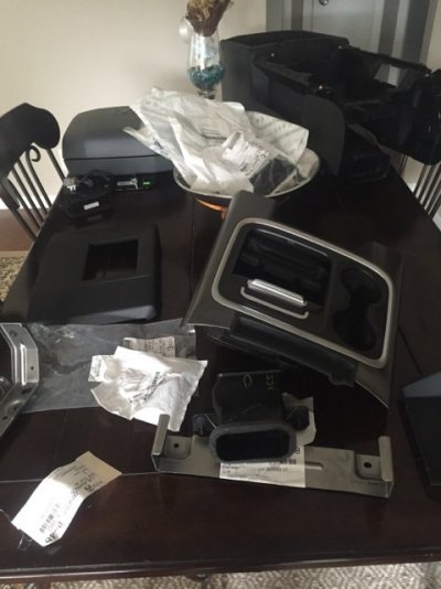

My parts list is

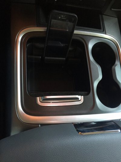

And final product will look like this with either diesel grey or black arm rest ImageUploadedByTapatalk1455921592.535874.jpg

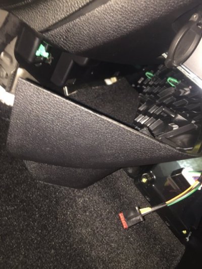

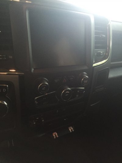

Today I removed old bezel (remove two t20 screws) and pry away. Then removed 4 screws holding bottom on existing console off. Once screws out I snapped off and unplugged the usb and cig lighter.

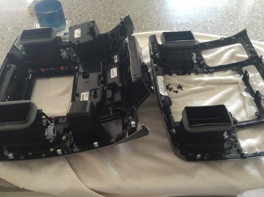

Next I took all transferable parts out of old bezel and moved to new bezel
Next I reinstalled new bezel

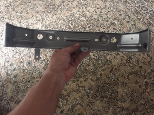

Tomorrow I will install console. It looking like mounting bracket may be a pain. I'll have o try and find some nuts and washers to hold this on 5260edfe09dec8432280dd12631cdc52.jpg

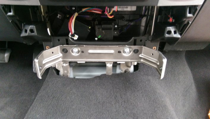

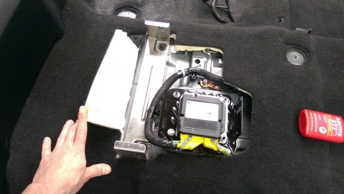

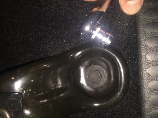

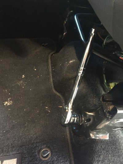

Next I removed driver and passenger seats. There were 4 bolts on each seat.

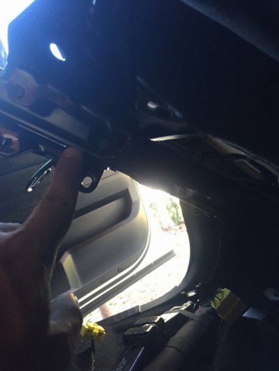

Then I removed jump Seat loosening 5 bolts 4 attached to passenger seat and one on driver side 5a1a247fc29c10592089555eb0cd392c.jpg

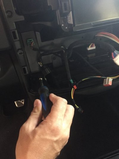

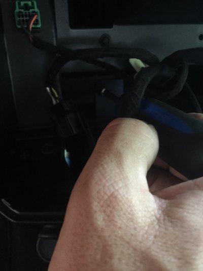

Next I removed wire harness out jump seat and spliced the usb,aux, and sd card reader cables 8323f415a37348c4da76425d2d2074df.jpg
Then I cut my duct work and duct tape together so flush. Changing from single outlet to dual outlet

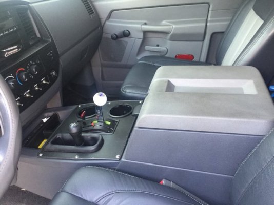

I swapped a console into my 3rd gen which was pretty simple. On the 4th gen I had to find one that came from the factory with it. They look so good.

Ok guys parts came in today. Will knock this out Friday after work. Heads up to anyone looking for jump seat. Mine is like new and will sell for rock bottom price. Pm if interested.

B&M pro Ratchet shifter

Here are some pics from my swap.
After you remove the forward lower storage tray, the front bracket will bolt on to the dash. There are allignment holes on the bracket that line up with dowels on the dash. You will need 2 bolts, 2 nuts, and some fender washers to bolt the forward bracket on. As far as the 4 bolts that hold the console to the brackets, I believe they are m6 x 1.25.
