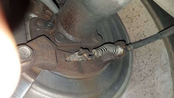

I always hit my parking brake linkages

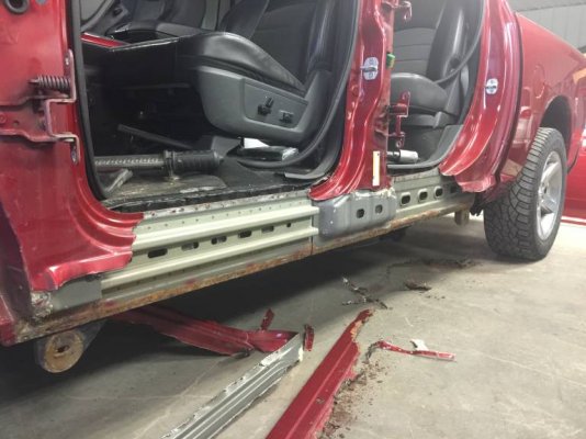

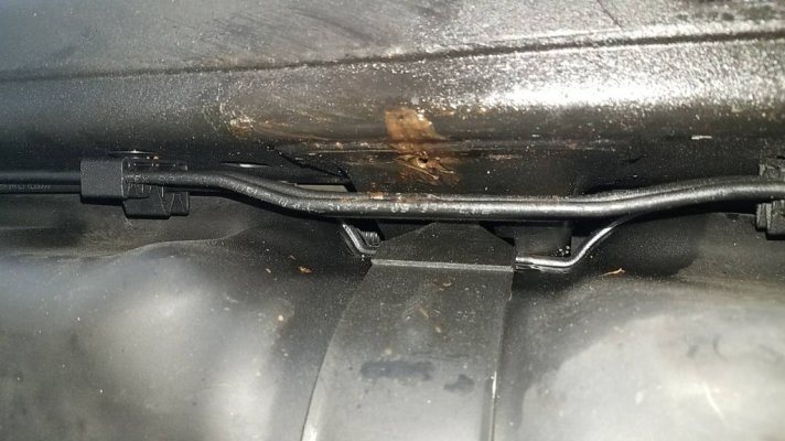

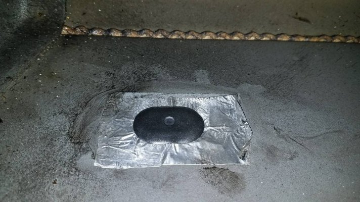

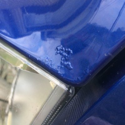

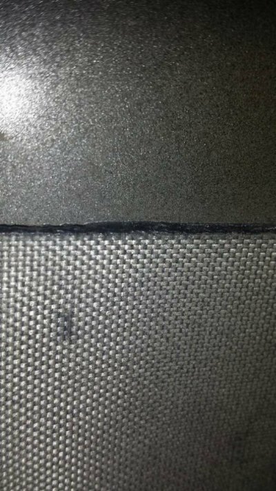

Picture of the fiberglass tape on the inside of the front fender

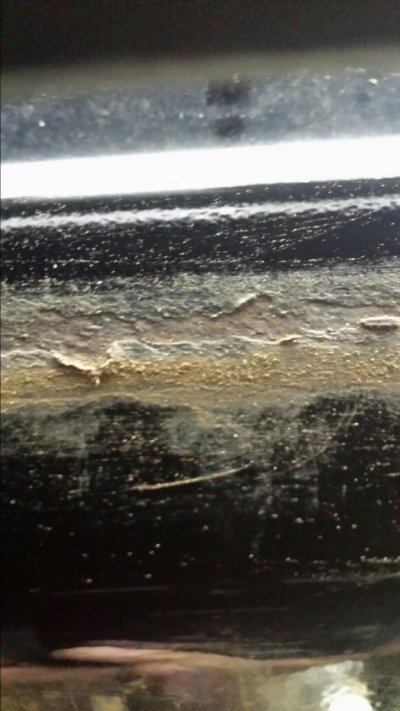

Picture of the rust forming under the fiberglass tape

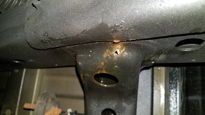

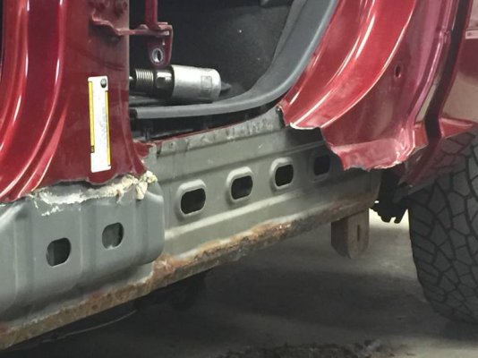

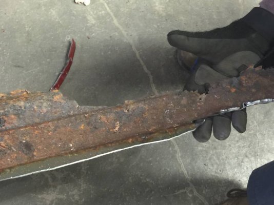

What can happen if rust forms under the fiberglass tape

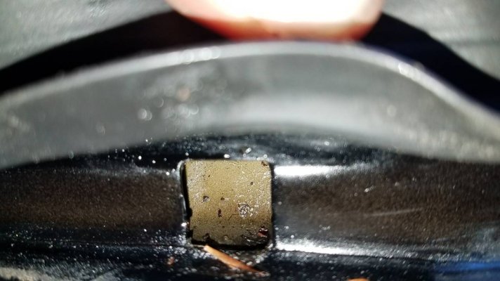

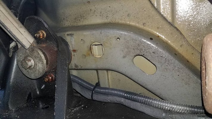

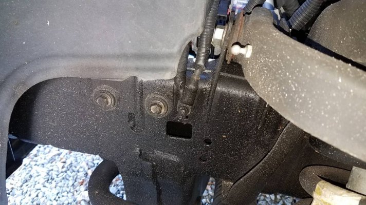

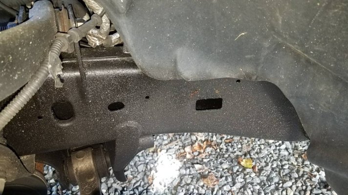

Great places in the front frame sections to get your 360* wand inside the frame

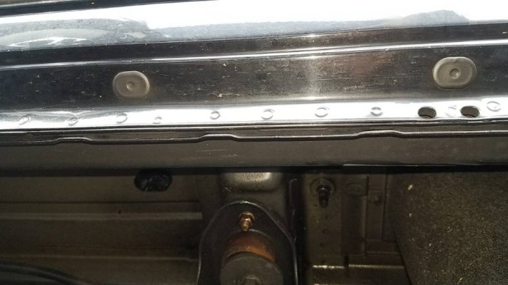

What can happen to the cab if the gasket between the cab and the bed isn't rustproofed

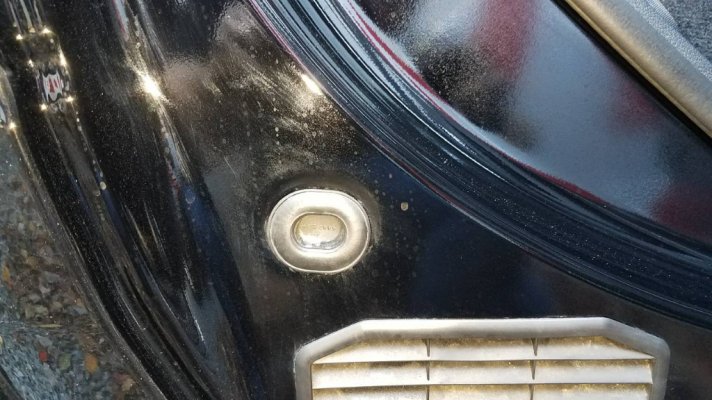

Take out as many of the rocker panel plugs as you feel necessary to get the 360* wand inside the rockers to coat them with Fluid Film. There are 2 cavaties inside the rockers. There is an outside cavatiy which you can access from the plugs on the outside bottom of the rocker panels, and the inside cavaty where you will have to remove the tape on the back side of the rockers. Make sure to get the cab corners. A great place to access the cab corners is the plug on the rear door jam for the seat belt bolt.
Plug to access cab corners with the 360* wand
I found this set of plugs on Amazon that fits decent in the holes that were taped over on the back side of the rockers: https://www.amazon.com/gp/product/B01N7W7I0C/ref=oh_aui_detailpage_o04_s00?ie=UTF8&psc=1

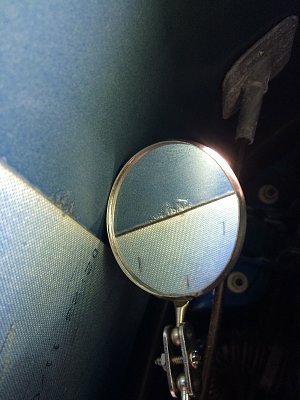

Last place to go is to the hood. The corners of the hood next to the grill will corrode over time if not treated. There is no place for the moisture to go. Fortunately theres a hole in the underside of the hood right next to this corner to get the spray can 360* wand inside to treat this corner.
What will happen to the hood if you don't get something oil based in these corners
