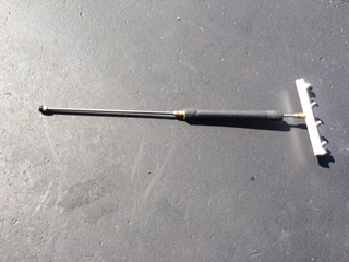

Fluid Film, Boeshield, and Krown T40 all work well for this application. I would also add to remove the tail lights on the newer Rams (2 torx screws) and spray the inside of the box inner/outer.
See attached pics for undercarriage spray wand I made. It rolls on casters with 4 nozzles. The spray head came from Amazon and then to Lowes or Home depot for extensions and fittings. I added pipe insulation so I don't scrape my rockers on lower vehicles. Works well with just about any pressure washer.

That's pretty damn ingenious!
Thanks didn't even think about taking the rear taillights out that's a great idea
