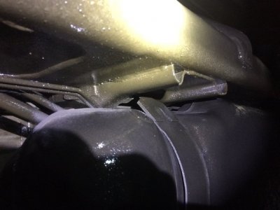

Harbor freight airless paint sprayer pictures as I promised. As you can see the 3/8” plastic hose has been bent so it will meet the bottom corner of the cup when the gun is pointing up in the air.
And the other two pictures first one is the passenger side second one is the driver side if I am laying under the truck looking towards the rear of the truck. (On my back looking towards my feet) You can see the two giant holes at the bottom of each side. Completely different design than yours.
One more note about the airless paint sprayer, I know fluid film says not to use them but I got to say i’m so impressed I might just skip the air Compressor from here on out. It’s not as fast but did the job very well. And it’s hard to beat a $19.99 spraygun and not having to run your big compressor.
Yeah thats clearly drain holes in those mounts. Wow thats great you HD guys don't have to worry about them rotting out, just keep them coated. WTF were they thinking in the 1500s??
Might have to look into that for next year, that looks a lot less cumbersome than having a compressor and hose to worry about
You will be dealing with an extention cord. And a paint sprayer that could die on a wim. The one downfall of the airless sprayer is the “power” if the spray. Its not pushed out of the gun very hard so you have to get closer. It makes a good cloud though. But its not as precise of a spray. If you want to test it out just buy one, test it with vegetable oil and see what you think. If you dont like it then return it WITH THE receipt. I had the first one i got lock up on me when testing. Had to get another. Also had to accept that I may have to stop in the middle drive to Harbor freight to get a new one if it breaks again.
