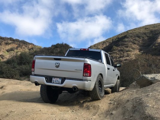

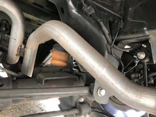

Got to test the shocks/springs early this morning, couldn't put the bumpstops to the max, so the coils are a lot stronger than factory,
This is before with the shocks fully compressed (though i had the rear disconnected here)
42619834970_440f5d09a1_h.jpgUntitled by Wrangler RSM, on Flickr
This is after
I guess i could try to disconnect and see if i can get the springs to fully compress, but i don't know at that point if the coil springs will like that, this seems to be what the springs will be fully compressed with the weight of the vehicle on either side.
43368673150_193ec163fe_h.jpgUntitled by Wrangler RSM, on Flickr
Also, i have about 2" or so of naked shock shaft with the coil stuffed
44460444634_4310962424_h.jpgUntitled by Wrangler RSM, on Flickr
So it will be a good idea to add 1" bumpstop to play it safe.
Little better drop as well, i was expecting to be able to keep that 1" uptravel, but oh well, it's what it is for almost 2" of downtravel :)

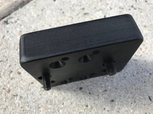

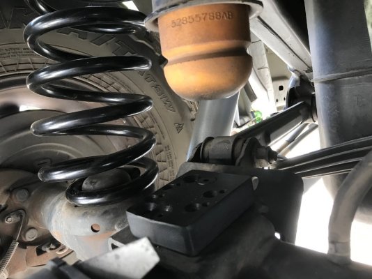

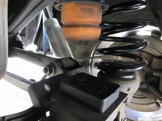

Had some Metalcloak 1" bumpstops i had in my Garage back when i had my JKU, Picked up a couple of bolts and nuts to fit the RAM bumpstop pads from Lowes, and they fitted like a damn glove haha
43375264510_2d089700b3_h.jpgUntitled by Wrangler RSM, on Flickr
30250236637_11130d91a1_h.jpgUntitled by Wrangler RSM, on Flickr
30250236597_1ae32e99b9_h.jpgUntitled by Wrangler RSM, on Flickr

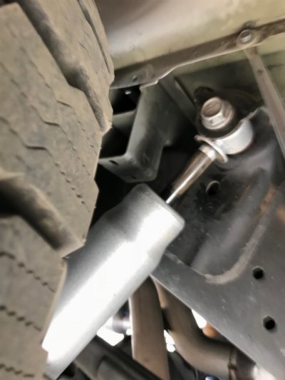

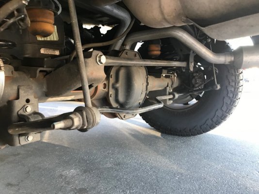

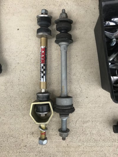

Removed the aftemarket sway bar links and added my stockers back, when they go out, i'll buy stock replacements, here is a side by side view, that tube in the middle where you can see the sticker is the one banging on the bushing caps, i can tight the bushing as much as i can to prevent that, but couple of days later the bushings will deflect as expected, and the hole assembly gets loose again, and the thing will start cluncking like a mofoker going through speed bumps and the like.

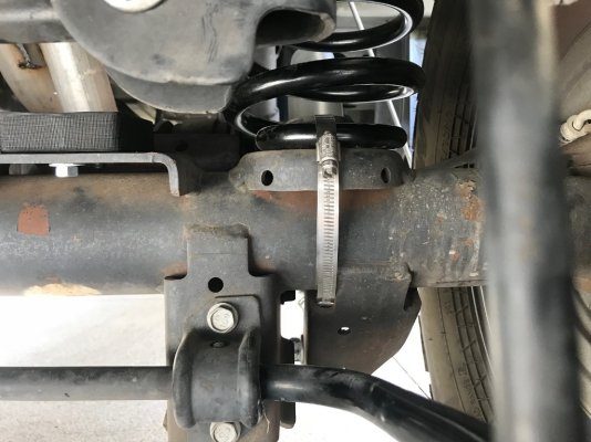

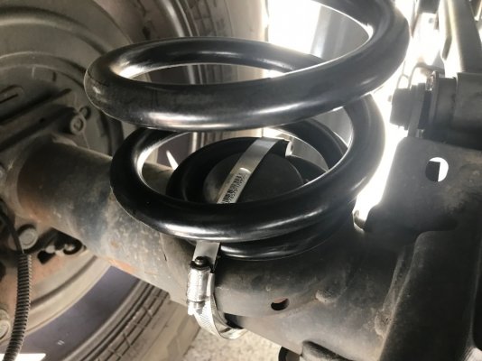

Also added my rear coil springs retainers, $1.50 from Home Depot, 5-7" steel hose clamps. those suckers aren't going anywhere haha, i don't think i need them after adding the 1" bumpstops, though this doesn't hurt anything either, so they're more for the just in case.

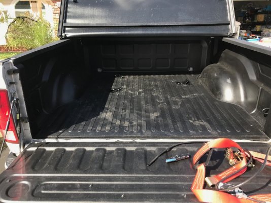

Added DeeZee HD bed mat, fitted like a glove, had to cut 3 holes to fit the thing on top of the brackets holding the spare

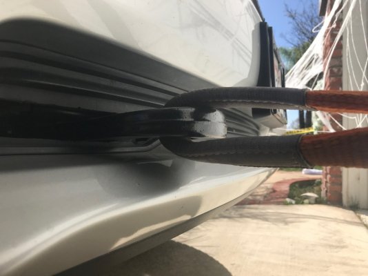

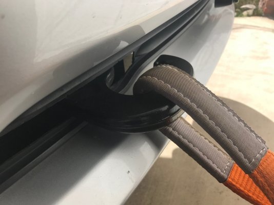

Actually, I have a question on your tow hooks...I have a 2017 Express...and NEED tow hooks. Some recommend fabricating a special bracket so they can face outward (the "correct" way) because of clearance issues. Sme turn them inward like yours.
How is the clearance between the hook and the bumper on yours?
Is there anyway you could snap a pic of two up close, perhaps even with rope or straps through them, next time you're messing around? thanks!
ram1500rsm
ram1500rsm
Jul 24, 2018
4,891
5,413
Trabuco Canyon, CA
There were no instructions in the box, and if i remember correctly, that’s the only way they fit naturally in their mount, I tried to reverse them and the bracket holes wouldn’t align in the mount.
I’ll snap some pics for you this morning.
ram1500rsm
ram1500rsm
Jul 24, 2018
4,891
5,413
Trabuco Canyon, CA

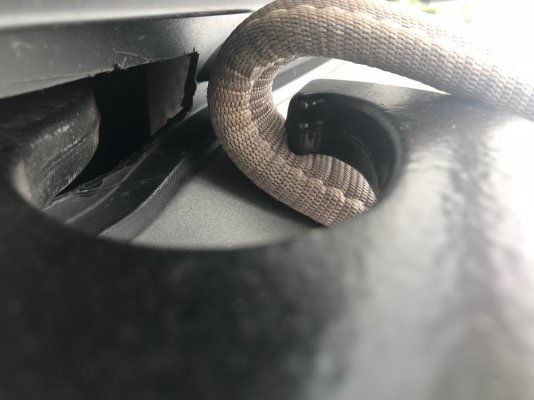

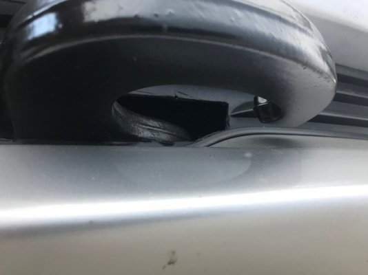

Here you go, this is all passenger side just to give you the idea, clearance is the same on the driver side
44740130565_04bbfa2ff8_h.jpgUntitled by Wrangler RSM, on Flickr
No problems fitting my ARB recovery strap or even the tow strap i have through the hook, sure it touches the bumper, but it wouldn't cause any issues.
30713872077_39267661f4_h.jpgUntitled by Wrangler RSM, on Flickr
Once it goes inside the hook, clearance is fine
44930016974_7d6782050a_h.jpgUntitled by Wrangler RSM, on Flickr
45654792281_4e2427193f_h.jpgUntitled by Wrangler RSM, on Flickr

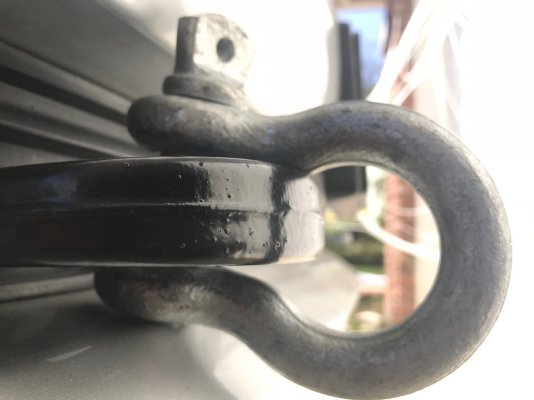

If you're trying to fit a shackle, then yes, that might not work well for the factory bumper, but i remember i was trying the same, assuming the bracket is reversed and the hook faces the other way, clearance will be the same because of the way the hook mounts, maybe like you said you'll need some sort of bracket that changes the way the hook fits, i don't see how using the stock holes/factory hook
45654793601_152f80db06_h.jpgUntitled by Wrangler RSM, on Flickr
In the pic above, the schackle itself rest at the bottom of the bumper in this pic, and the pin will rest at the top, if you put pressure on a pull, chances are the bumper might get damaged.

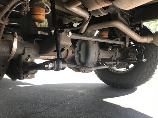

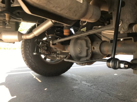

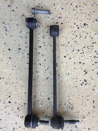

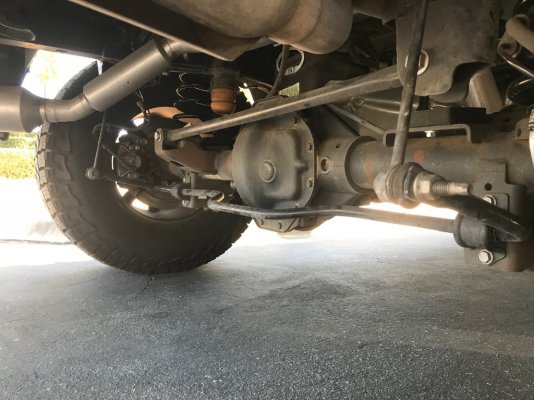

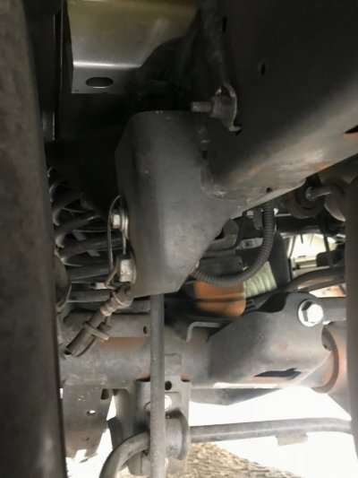

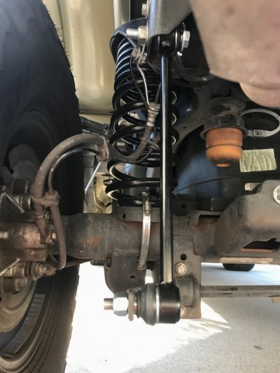

Installed longer rear sway bar links, (Thanks to 78Staff for the inquiry :)), the links are from Teraflex, company that makes a lot of stuff for Jeeps, i had these laying around in my garage from back when i had my JKU, and i wanted to test fit them to see how the rear would look with those in place. Honestly i didn't even think i needed longer links as the truck felt ok, or ar least i thought it did, so this happened to be a test that i ended up liking a lot.
Factory sway bar link measurement: 11 1/4" eye to eye
Teraflex 1754500 measurement: 12 1/4", eye to eye, $56 from Amazon for the Kit (2 sway bar links with lower nuts)
In this picture:
Longer link is the Teraflex 1754500, shorter is the factory RAM 1500 sway bar link
The bolt at the top is the factory upper sway bar link bolt, and it'll be too short to use with this links.
32012224548_0f40164b06_h.jpgUntitled by Wrangler RSM, on Flickr
Bought some larger ones from Lowes
M12x1.50x70
32012228738_933a965b6d_h.jpgUntitled by Wrangler RSM, on Flickr
And this is how it looks mounted, fitted like a glove, only thing you'll need if you do this links are the upper bolts, the factory nuts will be reused with the new longer upper bolts.
45833876492_33b16312fe_h.jpgUntitled by Wrangler RSM, on Flickr
Before:
44902086745_90de30239f_h.jpgUntitled by Wrangler RSM, on Flickr
43998312360_af75eb8b2e_h.jpgUntitled by Wrangler RSM, on Flickr
After:
44982441815_81c310e55a_h.jpgUntitled by Wrangler RSM, on Flickr
30956451757_f3d4ed8ac6_h.jpgUntitled by Wrangler RSM, on Flickr
For the best part, the truck actually handles better than before, and like i said in the other thread where we were talkking about the mod, is not that the truck did handle bad before, but the difference it made after is nice, cornering, crossing speeds bumps diagonally, etc.
