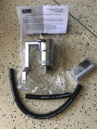

Got the UPR catch can installed today, nicely packaged, all assembled, but both hoses were about 1" short, not a big deal as i had some fuel hoses laying around, first time they had sent something that doesn't work right from the get go though, this is like my 6th or 7th time i've ordered a catch from this company, i'll contact them to let them now.
46051632131_5b80eaec10_h.jpgUntitled by Wrangler RSM, on Flickr
45327153784_e477d23b89_h.jpgUntitled by Wrangler RSM, on Flickr
