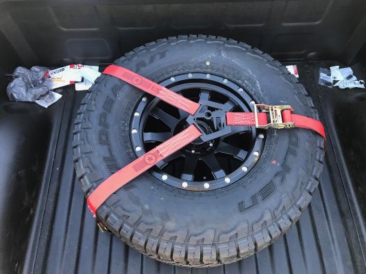

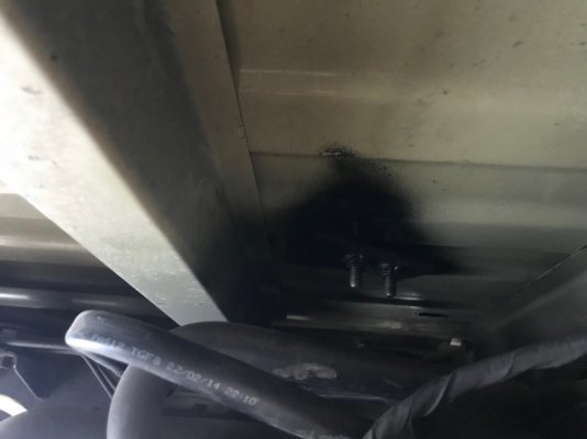

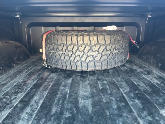

Got to work today and mounted the new full spare inside the bed, i took off the factory spare from underneath, and tried one more time to mount the full spare in the factory location,... maybe a 295 will fit, no way i could mount the 315 under there, so i threw the factory dunut in the garage and will be in Craiglist soon for $50 :)
The instructions on the nfab rapid spare mount do suck, the bolts provided in the kit are too short, so i had to go to Lowes and bought similar ones 2" longer, and i ended up drilling 4 extra holes, mostly my mistake, and mostly because this thing is also a universal mount.

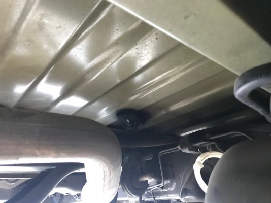

I couldn't mount the main bracket in the 6:00 o'clock position (from the front of the truck), because one of the holes goes through the bed frame rail underneath, and there is no way to bolt the bracket in there, i drilled the hole not knowing of course the frame rail goes through there, so i had to reposition the damn thing after drilling all the holes initially, and bolted the main bracket in the 3" position, left one of them at 10:00 and drilled the other set of holes at about 8:00 o'clock
Spray painted all the holes with black paint, and covered the extra holes with 1/2 nylon plugs from Lowes.

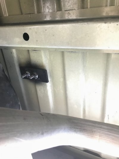

29769832847_c12f9c5f56_h.jpg42895228690_e89ff50814_o by Wrangler RSM, on Flickr
This is how the brackets are bolted to the bed, i ended up requesting assistance from the wife, as there is no way to hold those brackets underneath with just one oair of hands.

The whole 100lbs of weight in that place doesn't seem to have affected the height of the truck, which is a plus, i haven't installed the air bags yet.

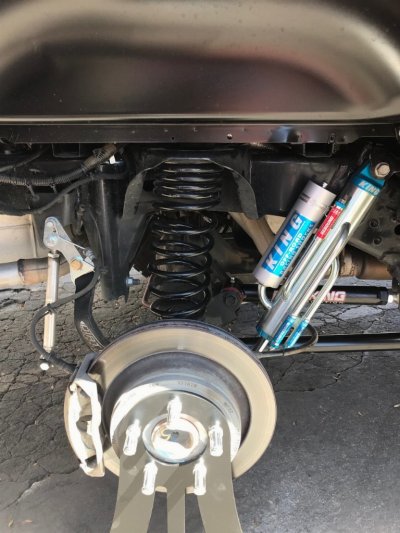

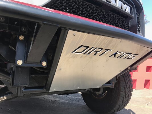

Man, i wish i had the money to afford the Dirt King Fabrication long travel setup, it's pure dope
44277813974_ea5a7fec05_h.jpg by Wrangler RSM, on Flickr
44277814874_3f8fa3874f_h.jpgUntitled by Wrangler RSM, on Flickr
44085779155_3edb3b64d6_h.jpgUntitled by Wrangler RSM, on Flickr

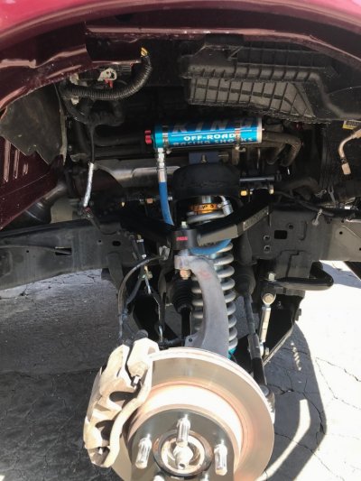

Love the front bumper, simple, lightweigth, and it must be a breeze to install
44996719271_f2b30d8928_h.jpgUntitled by Wrangler RSM, on Flickr
44277811664_48d602ead4_h.jpgUntitled by Wrangler RSM, on Flickr

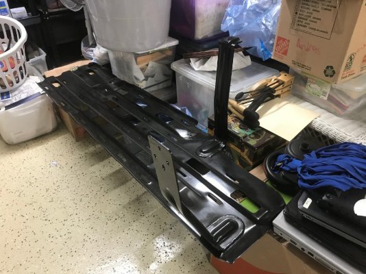

Gas Tank skid showed up yesterday, so i tried to install it today. No way to get it installed as a plug and play thing, at least on my truck. i wouldn't have no issues drilling the frame to install the needed cross member, but the skid has two brackets, one fit as expected, and will need just a washer and nut, the stud is already in there coming from another cross member directly above the gas tank, the other bracket also bolts to the frame in a different spot, (see below, bracket with 4 holes), but i think i'll have to dismount the gas tank so i can drill the frame, and there is a chance that 2nd bracket will need to be bent slighty to clear the control arm, i don't know how complicated will be to drop the gas tank, but i'm thinking i'll need a little fab work, so i'll start calling some offroad shops to see if this is something they can do for a moderate price.

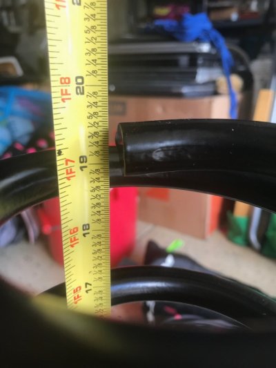

I did some measurement on the coil springs to check free lenght, the Icons are 19.5"

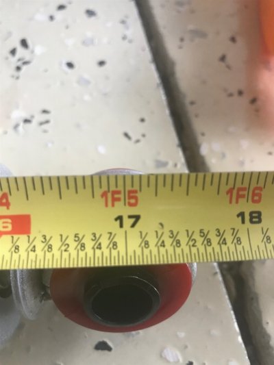

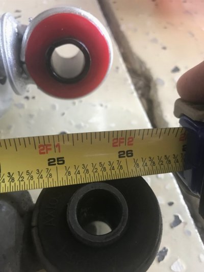

Shocks will fit without any issues.
Rancho RS999269 measurements, 17" compressed, 27 3/8 extended
44381987714_69ab8c3e89_h.jpgUntitled by Wrangler RSM, on Flickr
44381987204_b3540eaa59_h.jpgUntitled by Wrangler RSM, on Flickr
Compared to Mopar stock rear shocks, 16.5" compressed, 25.5" extended

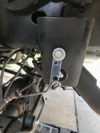

Looking to see if i can get a piece of something to extend the brake lines, seems easy enough, and from the kits i've seeing from the 4-6" lifts, they are extending the brake lines with just a little rectangule thing that seems to be 3-4" long, so i'll see what i can i dig from my Garage or Lowes

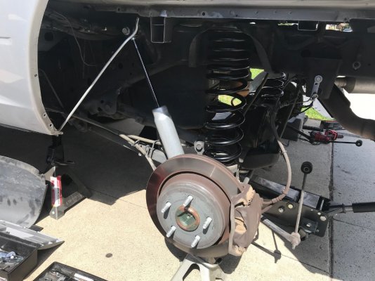

Got the new Icons springs and Rancho shocks installed.
Here is a side by side view with the Icons, i'll be measuring the stockers to see how long they're.
45167406571_34282b8dce_h.jpgUntitled by Wrangler RSM, on Flickr
The install went easy, not a lot of things to disconnect
Took the wheels off, the fender liners off, disconnected the upper sway bar links, brake line brackets the speed sensor plastic retainer, and also the fender support bars, (only the top portion besides the shocks upper bolts, then lifted the truck from the rear diff, and placed HD jack stands under the frame, close the rear LCA's, after that, dropped the diff down, then realized i needed also disconnect the track back braket (axel side), to give me more droop, and that was it, the factory coils came out without a sweat
45167406481_f1ebe0a667_h.jpgUntitled by Wrangler RSM, on Flickr
To get the upper shock bolts out, i used a 6" wrench from Harbor Freight, fits like a glove in there.
44256202445_6fe77f0e60_h.jpgUntitled by Wrangler RSM, on Flickr
Bolted the new springs, they're longer but they'll fit if you put some weight on the hubs and push the axel down a tad.

This are my brake entension brackets, $2 at Lowes for a pack of 4 :)
44256202545_71d8cbaf4f_h.jpgUntitled by Wrangler RSM, on Flickr
43353322830_7597c095f3_h.jpgUntitled by Wrangler RSM, on Flickr
