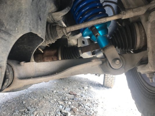

Decided to do a little experiment removing the front sway bar, why ? wanted to test how the truck felt without it while doing offroad and also wanted to see how close the tire could tuck at full compression for the purposes of perhaps stuffing some 37's
CV angle full stuffed
46560690395_3fde05bfda_h.jpgUntitled by RAM RSM, on Flickr
Plenty of room between the UCA and the RES even if i was jumping the truck
46560691395_c03bda3241_h.jpgUntitled by RAM RSM, on Flickr
No issues with coil binding either
46752637534_d931b9fd98_h.jpgUntitled by RAM RSM, on Flickr
315's at full stuff no sway bar
47423091862_f5b94c0138_h.jpgUntitled by RAM RSM, on Flickr
33599444038_0ca237c277_h.jpgUntitled by RAM RSM, on Flickr
Impressions without the sway bar:
There is more sway as expected, the Kings do a good job around corners though so cornering didn't feel super sketchy, but rapid wheel corrections do suck as the truck sways like a boat left and right, i'm sure i could correct this for the most part if i had compression adjusters running them on the harder setting but i don't see myself driving without the sway bar long term anyways. Truck corners better with the sway bar as expected, and i like the feeling going fast with the bar to my surprise though i couldn't give the truck enough gas today to test. I was doing 30-35mph as our local spot was a little busy this afternoon so decided to play it safe.

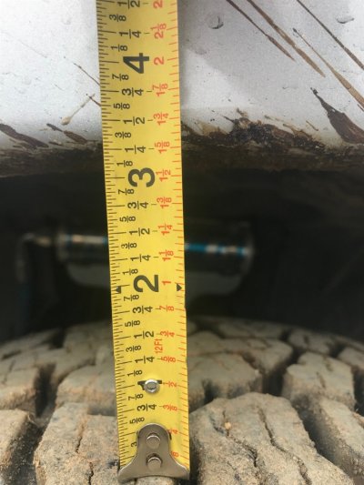

Without the sway bar there is 1 5/8" gap between the tire and the fender, this is with the Strut resting on the bumpstop
46560695915_6282031b0a_h.jpgUntitled by RAM RSM, on Flickr
32534094747_c15698c798_h.jpgUntitled by RAM RSM, on Flickr
Like wise with sway bar on, 3 1/8" gap
47423100412_04b5f4251e_h.jpgUntitled by RAM RSM, on Flickr
40509792053_835d941414_h.jpgUntitled by RAM RSM, on Flickr
Had to put the factory sway bar bushings back, as the new links i got from oreally's sucked balls, the bushings at least, 2 passes on the local trail at some speed at the bushing literally disintegrated, this set have 70k miles now, can you tell ?
33599453388_b21c0bdeab_h.jpgUntitled by RAM RSM, on Flickr
I think i'll stay on 35's until i can run Fibwerwerx fenders :)
