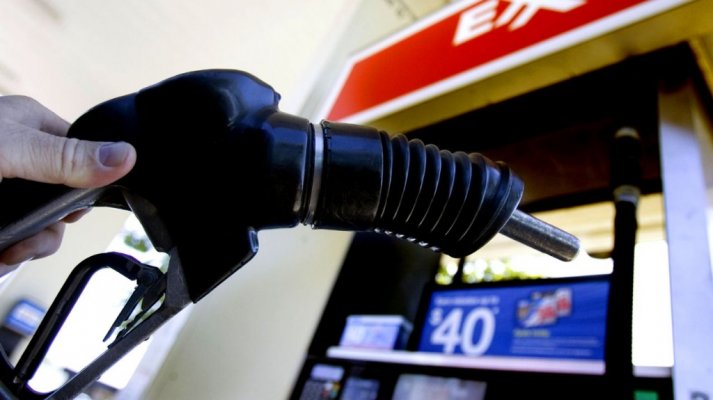

I actually found a gas station with the older style pump guns and when I filled up this weekend it didn't click off at all ...
I am starting to think that it's really not the evap system or the tanks but the pump guns at these gas stations that are very sensitive ... they have a sensor in them that has to be replaced if it goes bad, I asked a guy who was servicing the pumps at a newer gas station and he said the new pump guns are just horrible and they have no time to maintain them which is why these pump are causing problems for many newer trucks and cars ...
So there you have it .... this is actually not rally FCAs fault but more the new pumps that are replacing the older ones ...
I'll agree somewhat. I'm sure that the pump guns could be better but my truck is the only vehicle I've driven in the last (at least) 15 years that this has happened to.
I've lived in the same area since 2003 and I've not had an issue filling any car or truck (mine, my wife's, loaners, rentals, or borrowed) except my 2019 RAM.
