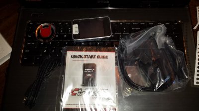

I unpack and get to work. Here's a tip, some people complain that the DCX feels "cheap" and I get that but considering what it does, I'll live with it, my biggest problem is that I have sausage link fingers and the unit is touch screen and not really big. Do yourself a favor and use a mechanical pencil with an eraser to make your selections...goes so much faster!
Ok, now I hook it up to my PC, walks you through the process which takes a few minutes and then you're ready to hookup to the truck. I take it outside hook it up to the truck and it says that I need to install a PCM calibration from Diablo...back inside I go...hookup to PC and it takes maybe a minute to install the calibration...then back outside. I hook it up to the truck and it has to calibrate my PCM to work with the tuner.

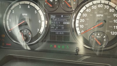

While it is doing this, I'm seeing every light on the dash go on and my EVIC says "No Bus". At this moment I'm terrified thinking I just made a huge mistake and bricked my PCM...truth is, its fine, it is the trucks way of resetting the PCM to accept the calibration but it also does this when loading a tune. So, I load the calibration and then I load the 87 Octane Tune for my truck, wasn't sure what the Diablo Tune did but I had a full tank of 87. It took a few minutes to load and after cycling the key a few times...we're all done.

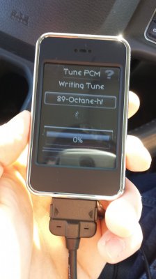

Ok, so I've had the chance to load the HF 89 tune on my truck and all I can say is WOW! It's like I have a brand new truck. It simply pulls so much harder than before. I feel like I've got a major engine upgrade. The truck seems lighter...more peppy if that makes sense.
It doesn't "gear hunt" as much as it did while stock and passing someone on the highway almost seems effortless. Now, I should say, don't expect to go from a lawn tractor to a Ferrari, that is unrealistic.
