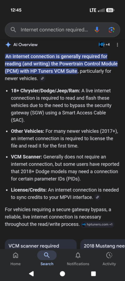

VCM editor .... Internet connection is required on the security bypass vehicles
VCM scanner sometimes on the above
I'm done... LoL
Waiting on ops response from feedback from HPTuners
AI agrees with me... LoL
An internet connection is required for initial setup, licensing, and updating the HP Tuners VCM Suite. It is also required for flashing/writing to many newer (2018+) vehicles and, in some cases, to prevent data logging pids from dropping. [1, 2, 3]
Key Requirements & Usage
  • Initial Setup: A stable internet connection is required for the initial installation and device registration.
  • Licensing & Writing: While older vehicles might not require it, many newer models (e.g., 2018+ Dodges, 2017+ Corvettes) require an active internet connection for every "write" or "flash" procedure to verify licensing.
  • Performance Data: An active connection is needed when using the controller unlocker or to prevent issues with logging.
  • Updates: Regular updates to the software (both stable and beta) require internet access. [1, 2, 3, 4, 5, 6]
WorkaroundsIf you are tuning away from Wi-Fi, you may need to use a phone hotspot to maintain the necessary connection for the software to operate correctly. [6]
AI can make mistakes, so double-check responses

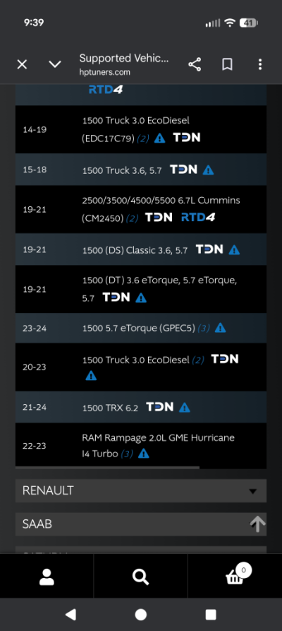

I didn't realize your Ram was that new.....2024
Doesn't show on the phone.
I'm assuming yours is a classic?
HPTuners only listing the etorque as supported for that year

I have 2, my avatar is my 14 RT, the 24 is a classic and non etorque. Yeah, my mistake, I read through the supported on the HP tuners site but it didn't register the etorque would be different.
