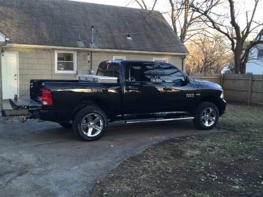

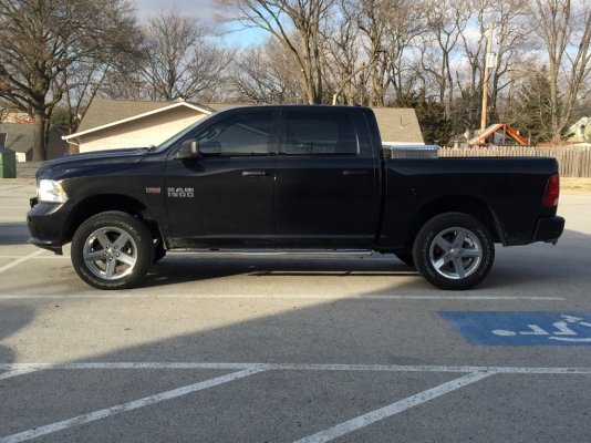

I just installed my bilsteins this morning and set them at 2.8. I seen too many posts where guys wished they would've done this the first time around. I also installed the 3/4' poly spacer in the rear. Monday i'll be getting my 275/65/20 duratracs installed then an alignment. But after the install this morning and a few miles around town it feels no different than stock...thus far!
Roughly 2.5", not bad eh
