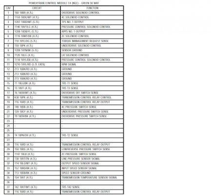

DESCRIPTION - PCM
The Powertrain Control Module (PCM) is located
in the right-rear section of the engine compartment
under the cowl (Fig. 5).
Two different PCM’s are used (JTEC and
NGC). These can be easily identified. JTEC’s
use three 32–way connectors, NGC’s use four
38–way connectors
This is the pin-out and there is no reference to TMR for a 4.7. The only YL/DG wire is for the 5.7. Doesn't mean the pin-out is correct but does confuse things when looking up. As long as it is working I'm thinking go for it. This might help other 4.7 owners as it has always been thought the TMR is for 5.7.

well according to your post, I must have the ngc, as I said in my post, my ecm has 4 connectors. I pulled bottom connector, found yellow wire with green stripe and cut it. sorry, about confusion, the pic only showed three connectors, the 4th was down lower, hard to get a good angle with that hose in way.

I have looked at the diagrams for a while now and I do not think this is MOD is possible with the 03 4.7 as it does not have TMR Sense. I Think this other guy... if he actually did cut anything 1) cut something other than what he thought, causing another component to not function properly, then suffered from the placebo affect or 2) he did the impossible.
According to wiring diagrams it is not possible, because the item does not exist in the case of 2003 4.7's.
I will however still keep this on my list of "make it a point to..." things and will physically search for the wire on my connectors. I will search specifically for this Yellow/Dark Green wire that was supposedly cut from the bottom 38-pin connector. If I do find it, I will remove the wire and give a detailed write-up on the results (sometimes around Easter).
Not trying to be a D*ck here, I just don't like it when incorrect information is given to people who are after accurate information about taking care of their vehicles. :Frustrated:

Post #42 is straight out of the 03 manual and I see no indication the 4.7 has TMR. Maybe a picture of what was cut can clarify what was done? Good luck...

I about ready to do this to my new to me Ram 2500.
Can someone point out the right wire in the pic?
it says #10, yellow wire, green stripe? But on the connection there are many spots where a wire is missing making it hard to tell which was pulled and which was just empty.

There is only one YL/DG wire, as for finding the #10 hole. Count all the holes whether empty or not and you will be at #10.
