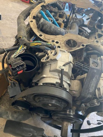

well gents, since no one told me I was a big ole dummy for looking at that 4.7L engine I posted about last week, I went ahead and went out and bought it. Good news and bad news.
Bad news:
-The dummy left it in the back of his truck with the intake manifold off and the ports uncovered during last week's rain storms, so there was a bunch of water, complete with mosquito larvae swimming around in it. I could look down into the intake and see water pooling.
Good news:
-I told the guy that with all the water in the engine that I'd have to do an immediate teardown to clean the water out and even doing that I'm running a huge risk with having other significant issues in the engine...so I knocked him down another $200.
We dipped the engine over and drained out most of the water and loaded it into my truck.
Aside from the questionable engine, I also got the 4.7 ECM, another radiator, fan shroud, two sets of motor mounts, oil cooler, air box, alternator, etc. etc. Basically everything in the engine bay since he changed over to a hemi.
My buddy went along with me to pick up the engine and once we got back to the house, we started to prep the engine and got it on the engine stand. After that we went ahead and drained the oil...well, we got to the oil eventually, after about, no kidding, probably a gallon of water. That said, luckily, the water and oil was completely separated. As in, the water was clear and the oil was black.
We then got started on the post mortem. Let's just say it didn't take long.

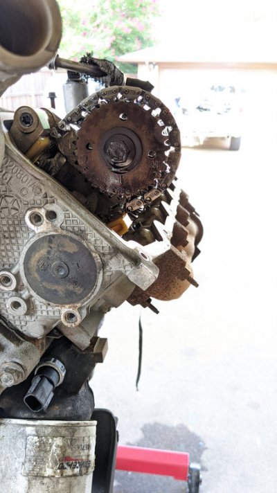

Oooh, pretty, clean new re-manned head...everything looks pretty normal on this side...
Well, a different story on the driver's side. This doesn't look good...
Ah, yes, just as I suspected, ole girl had a timing chain problem...tensioner failure, to be exact.
A lot more light through there than what you should be seeing...
Let's go deeper....Yup, there's yer problem dere Jim...

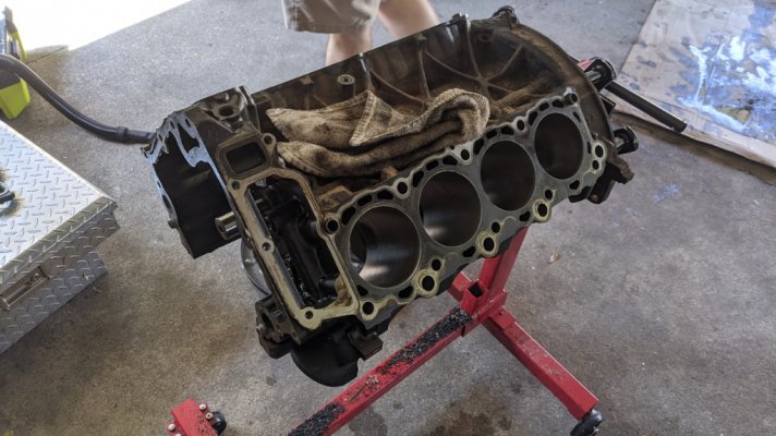

After we finished the post mortem, we turned the engine over and removed the oil pan, windage tray, and oil pick-up (yes, the pick was sludgy, but not blocked. I went ahead and sprayed everything I could see with WD-40 to get the water out (though it looked like the water just slid down the oil-coated internals and straight into the pan. I also removed all the spark plugs and we drained the water out of the cylinders and, where present and sprayed WD-40 down in there.
This was pretty much the end of the day, so that's all the further I got today.

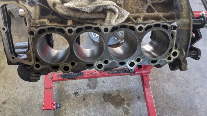

Well I spent Sunday doing further diagnosis and teardown. All four exhaust valves on the driver's side cylinder bank are bent. So as I suspected, the head had to come off. After removing the head and seeing that I wasn't able to get all the water out, as I had hoped, and seeing what it was/had done to the cylinder walls, I decided to pull both heads to clean the cylinders out as best as I could.
Unfortunately, the water had already done it's thing. So, hoping the best, we decided to further tear it down and remove the piston and crank to see if it could be honed out and to inspect the bearings (I mean, we're already this far, right?) Rod bearings looked really good. As did most of the crank bearings, but two in the rear had a little bit of pitting. Cylinders, where not rusted and lightly stained/marginally pitted, were glazed. Nearly every piston had at least some of the rings completely stuck in the grooves. I imagine this engine was quite the smoker.
Pictured below after a very light honing, before this the cylinders (where not rusted) looked like a glossy sheen of fresh clearcoat.
It was getting long on into the day by this point - we did do some preliminary honing, but I'm stilling thinking that I'm going to take this block to CMS and having them hot tank it and get their assessment on the cylinders. I have to take the driver's side head in anyway to get them to replace the valve guides and valves anyway.
