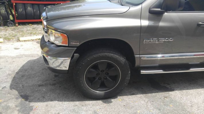

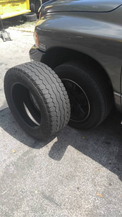

So I just installed these 35x12.50r20 when everybody told me they wouldn't fit and I would get rub. No issues whatsoever. Just fyi for anyone wanting to put this on those 02-05 1500 2wd 83a9bc1e9781a99ef6498e5eff988aca.jpg41d957c08dbeb7fa3107941aeb0c606b.jpg7f0910b673ab813ed21da2e259746a6b.jpg

Yes on stock rims 35s won't rub... buy aftermarkets with any type of offset and you will have rub.

yeah I just put 1.5 inch spacers and before I put I 6 inch lift I was rubbing but it wasn't enough to bother me. I get no rub with the 6'' lift
