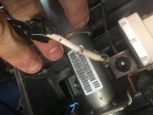

7c0288206ce591daebaae7fb48a5f238.jpg03f08072d5a739fdd68b39a9ef107e5b.jpg45ef33ec0d0bdac2b950aab9afb0a3da.jpg

that tape job isn't factory, somebody put in a kill switch , then removed before the truck was sold, what happened is you acted as the kill switch. now you have too reconnect where that wire was leading or better yet return to oem specs. Should'nt be too far from the end of that wire. Good luck.

I dug into it a little more, it looks to be a hands free system. They tapped into a wire on the main harness. Just found the broken end so I'm working on getting it together

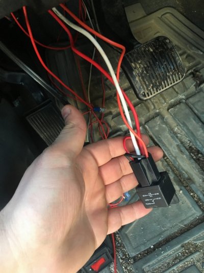

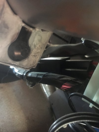

55caa7e23b7f054810a44bea8719e055.jpgc5e5f0e0160109544210da4de05c4575.jpg80f7442ec99021f8ca2602391c298936.jpg

That's what I'm working eith
sbarron
Feb 28, 2015
3,363
2,282
Wasilla, Alaska
Ok. I'm stumped. Lol. And old lo-jack system? Where do the pink and blue harnesses go to? Maybe to matching plugs? As in, if you traced those back would you find the place the OEM wiring would plug back together and you could pull that whole subsystem out?

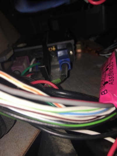

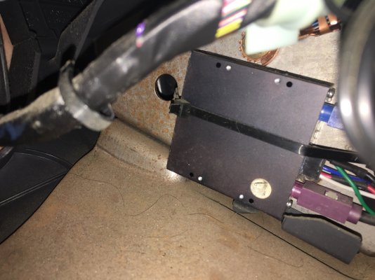

87866755a876de6072a1a8b8d7b2717e.jpg1d2ddf42fcc817a72f801bcdd2b54e5e.jpgd57f90aefb8bb48578318b03b9edbc9a.jpg

That install drips "professional". Lol. Sorry.
If it were me, I'd be trying to remove all that crap if possible.
