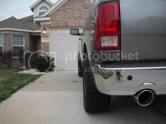

Yes, I am running them front and rear because I didn't want the fronts sticking out more than the rear. I also have the stock chrome clad wheels. I have had this setup over 100mph 3 times now and have not felt any vibrations with the cheap spacers. Here are 2 pics with the new rear drop coils showing how much the tires stick out of the fender with the front/rear spacers installed...
