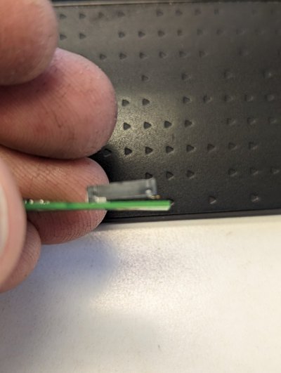

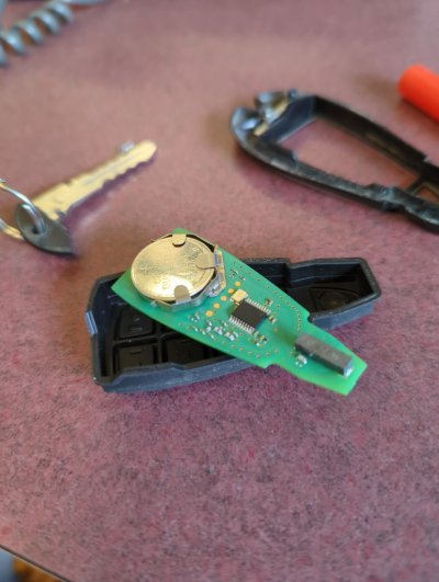

Found the problem, looks like I must've dropped the key, may try to solder
