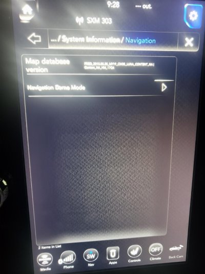

My 19 DT 12" version updated right after I bought...
Application Version: 33.3.0

FYI...
At the bottom of the 12" screen, press and hold the outer 2 icons/shortcuts for 6-10 secs to get into dealer menu ... Then go to the radio information screen and you can see what you're current 'application version' is since that's what these Panasonic radios go by. (& Compare to what I posted earlier).
My 2019 is on Application Version: 33.3.0
