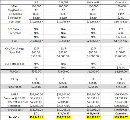

1) Cummins diesel engine warranty is 100k miles so there would be no out-of-warranty diesel engine repairs in the 100k timeframe I stated.
2) You DO NOT recoup any savings from diesel on fuel alone. It is a combination of resale value and fuel savings as shown in the chart below that I did a few years back. It actually needs to be updated because the value of my truck went up to $40k(I paid $50k and MSRP was $64K) when I looked it up a few weeks ago.
3) I have owned three Cummins diesel and none of them had any major repairs needed on them until around 200-250k miles. I currently have 140k on my truck with zero engine repairs besides a water pump that replaced due to a recall even though there was nothing wrong with the old one. My friends who own Powerstrokes and Durmax's, that is a different story.
However, I agree with you. You buy a diesel because you want more power even if it might costs you more money depending on your location and local prices. Similar to how a 6.4L owner pays more for that over the 5.7L in the 2500 or a 5.7L owner pays more for that over the base V6 in the 1500. Although in those options, the more powerful engines generally use more fuel, not less like the diesel option does.
To me, even if the diesel cost $2k over the course of 100k miles I would still think it is a good value for what you get in return.
