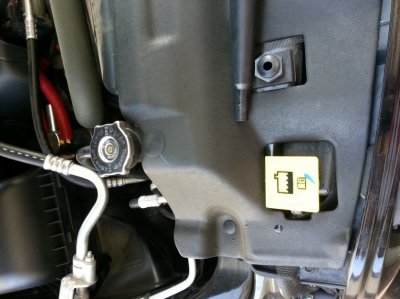

Okay I'll try the blowing method, seems the easiest. So I know are you referring to silver or yellow cover?

Do I need to pop the silver cap? In my above picture?

Way to go! My Rad Cap is on the overflow bottle on both my Hemi set-ups, thats looks like a good set up compared to the no cap on the rad itself Mopars. Danny
