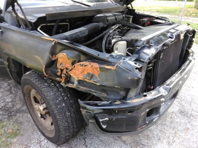

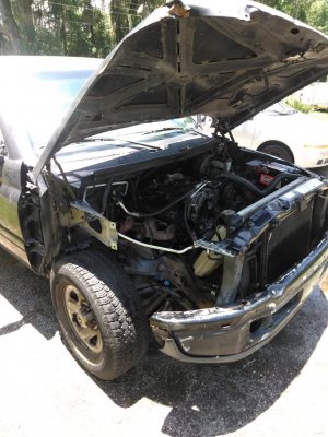

-ill post a pic. the truck was wrecked in the front right fender. it looked like only the hood, headlight, passenger side mirror and probably alignment were damaged. it didn't even bend the a/c tubing inside the right fender. radiators were not damaged. I found the headlight and running light leads and electrical taped them to make sure they don't touch anything.
The pic with the right fender on is the "before" pic of this truck. The second pic with the right Fender off is after I did the water pump. right now that's how it looks.
( by the way it makes it much easier to reach inside the hood area without that fender) - not hard to remove.
you can see the a/c tube still intact. the damage looks worse than it is.

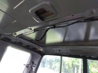

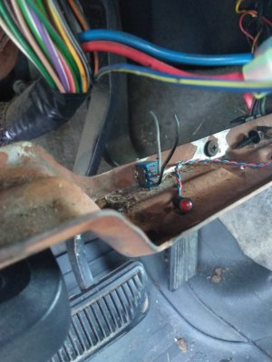

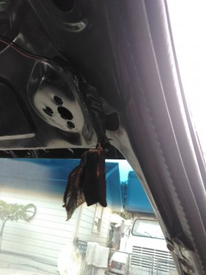

I checked the dome light (see pics) plus there was a plug going down the passenger-side windshield column I pulled out (not sure if it was plugged into anything - see pic)
I didn't see anything obvious with the dome light wires. could the dome light switch on the dash short out? seems like it would just be "on" but that's the only thing I have left aside from an open wire jacket on that circuit I can't visually see.
so far nothing found

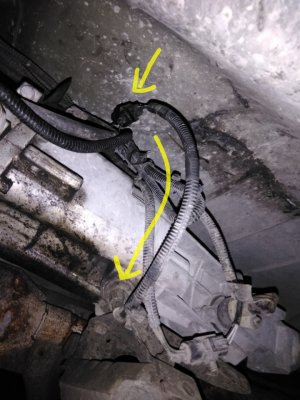

IMG_20180608_221613.jpg IMG_20180608_221053.jpg update. although the vehicle started before I did the water pump, the attached pictures are from looking up towards the top of the bellhousingme laying underneath the truck.
The blue arrow shows the plug and the wire broken off that plug. that goes to the other pic of the wider view and yellow arrows.
In the yellow circle I have found at least two wires that I can see where the sheath is exposed and broken or possibly shorting.
I'm having a hard time even taking a picture of these exposed wires and even the broken wire that I can verifyis broken off that plug. .
I'm thinking I have to eliminate the plug and just splice the wires together for the one plug. But I probably need a lift to get up to the other wires because I can't get my two hands up in there laying underneath the vehicle.
I'll bet I had some visitors chewing on wires up there. I've never had this happen on any other of my vehicles parked in my driveway.

That tranny wire could be a park safety switch, if it broke then no fire at all. Try fixing it completely. That also might be part of your power draw problem from a bare wire touching. Damn rodents! Good luck buddy!

UPDATE : GOT IT RUNNING!
it was the CPS. When I took the old one out, one of the wires was not connected and the other one was still intact. I changed the sensor it cranked right up. All that wire chewing by mice that went on when it sat in the field must have chewed on the crank sensor wires just enough so they were still making contact. When I changed the water pump I probably jostled them when I was messing around behind the distributor. This probably pulled the remaining strands of copper connecting to the crank sensor off.
