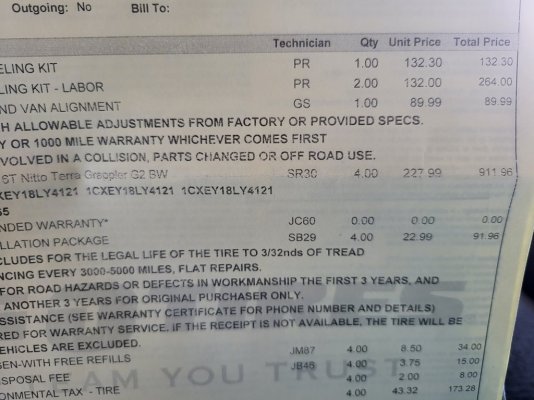

Having a Traxda 2" lift put on tomorrow, along with 33 inch Nitto tires. The lift itself is around $130. Installed, plus labor and alignment, is $525.00. Tires are $911.00.
Nov 20, 2018
77
Riverside California
2018 2wd
HEMI 5.7 Revolution 4.88s
Are those tires "blems" ? That might be the only way you get close to that number for 4 tires, they run around 350 each on average ... picture of the invoice or it didn't happen !!!

Nice, but that doesn't show they are 33" tires and those are Terra Grapplers G2s
He said nittos…terra grapplers are nittos. And stock tires are 33’s…if he leveled his truck im sure he at least got stock size tires….

I bought Cooper 10 ply AT3s a couple of months at Walmart for $132 each.
I never questioned that they were nittos lol .... terra grapplers are less than ridge grapplers is what I was referring to ... and yes I found grapplers for $227 online but in size 31s not 34s ...
Gotchya, well he never said he bought ridge grapplers…just nittos….and he never said he bought 34’s.

Sorry for the delay in replying. Just had a minor heart procedure. Yes, they're Terras, not Ridges. The tire guy said they're equal to 33".
As to how it rides, it's great. Front end is nice and level. Smooth ride. Hasn't affected the gas mileage, either. Still getting around 20 mpg average.
