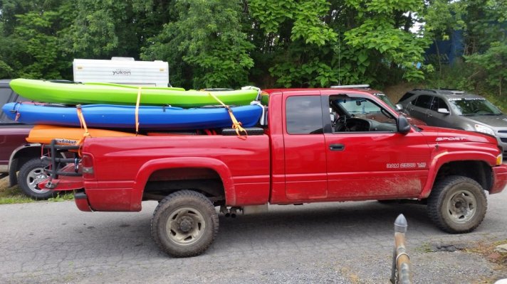

You need the quad cab doors. They are specific to 98 to 2001 1500/2002 2500.

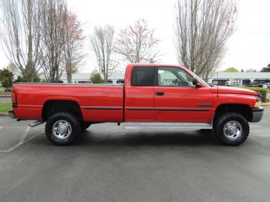

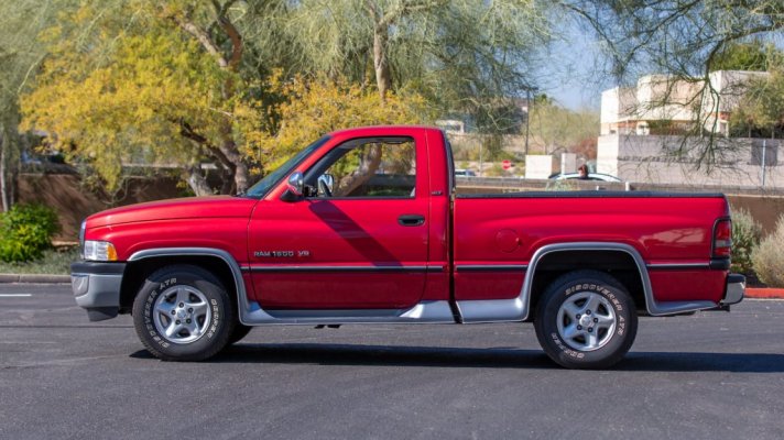

The regular cab doors and the extended/CLUB cab are interchangeable.
The full door quad cab stated with the 2002 Ram 1500. The 2500/3500 got it in 2003.
The quad cab doors are squared. The regular/club cab are rounded.
2nd Gen Quad Cab...98 to 2001 on 1500 and 98 to 2002 on 2500/3500
3rd Gen Quad Cab. 2002 to 2008 for 1500 2003 to 2009 for 2500/3500

Club cab...no rear door
1500 or 2500 will work they are the same.
