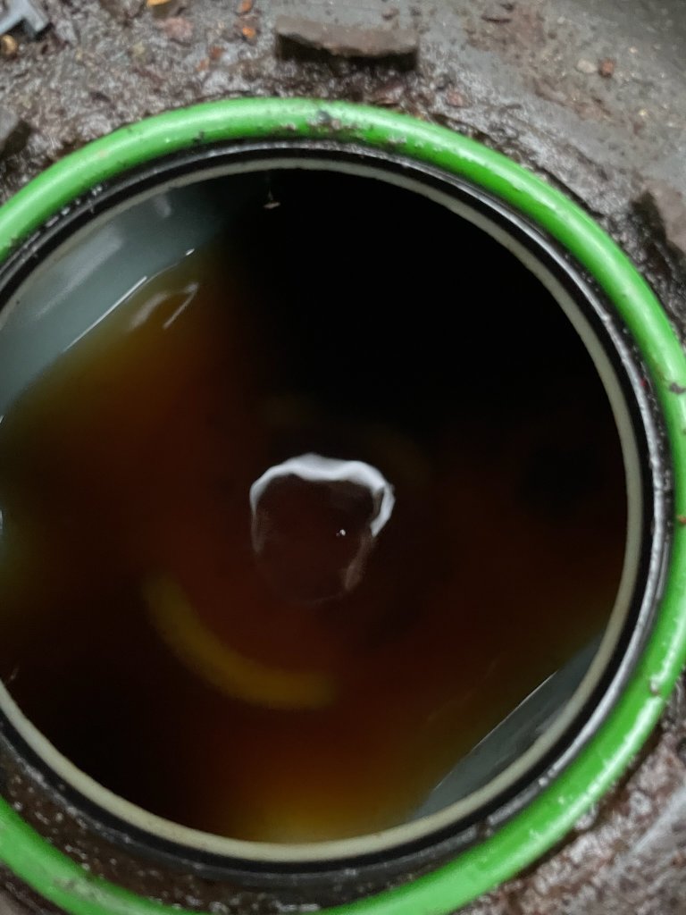

I bought an 04 not long ago that sat and had similar issues. The filler neck rotted from the inside into the tank and the fuel looked like river water.
The oil looked fine on the dipstick but was so sludged up when I went to change it I had to use a screw driver to break the sludge seal to get the oil to drain.
Turns out it had 3 bent pushrods on the intake side and all that gum slowly bent them and eventually lead to it backfiring so badly it melted the intake ports and blew apart a cat from all the fuel being dumped in.
When you changed the injectors did you take a fuel sample? Could have debris in the tank and just clogs the injectors within moments of running.
