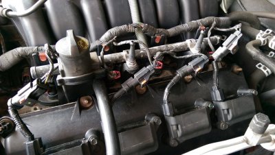

Hello fourm,
I bought this truck in spring it had a slight misfire I ended up changing out all the spark plugs someone had started to change them out but stopped when they got to the brake booster. They also put short spark plug wires on the motor. After I changed all the plugs and secured all connections the misfire was gone, but I am now considering changing out the coils because of how split and rusted they are. OEM looks like it is a coil with spark plug wire running across the motor. I noticed these today when I was plugging in my truck.
https://www.summitracing.com/parts/pfs-30561/overview/year/2005/make/dodge/model/ram-1500
Does anyone have any experience with eliminating the spark plug wires entirely? I figured it already has these short spark plugs on it and I don't see any reason why these dual spark plug coils wouldn't work. I like the idea of keeping the engine tidy, but I am also planning on hauling a 27 foot goose neck camper full time.

Yes you can. You can either cut and solder new plugs on or get the adapter pigtails (I opted for this on my Magnum).

I have the msd coil packs and wires and I absolutely love them and completely suggest them they're easy plug and play no soldering you do have to keep the criss cross wiring though

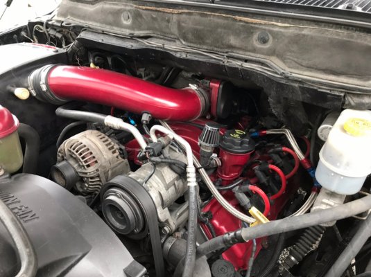

Also if you put the dual plug coil packs on you have to get the newer style valve covers also. The bolt pattern is completely different. I doubt you will see any improvement one way or the other with the newer style, but they are tidier then the crossover wires. I have the shortie wire setup on mine without any problems e044f6df0900e0ae2d2486a4c1912136.jpg
