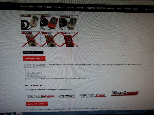

Mike49321
Oct 24, 2019
29
Portland, mi
2008
HEMI 5.7
I just used a superchips 3865 to turn off mds. What a difference! I just wish I could understand how to purchase and download the trans tuning to my tuner. Lol
HemiLonestar
Navy Badge Coast Guard
Jun 1, 2012
6,815
4,690
MD
Go to Superchips.com/updates, that'll be the page below. Download "Spark" to your desktop. Install the program. Been quite a while since I've done this, but once you load the program and hook up your tuner it should give you what downloadable options there are. Last time I hooked up my 3865 I got the trans tuning and performance datalogging (been like 8yrs OR so lol). If you don't have a cord to connect the tuner to your desktop or laptop (which has to be running a minimum of Win7) you'll need to get one.
Mike49321
Oct 24, 2019
29
Portland, mi
2008
HEMI 5.7
I haven’t done a lot of research to figure it out yet, but I did notice on the superchips website that the 3865 doesn’t seem to exist..
