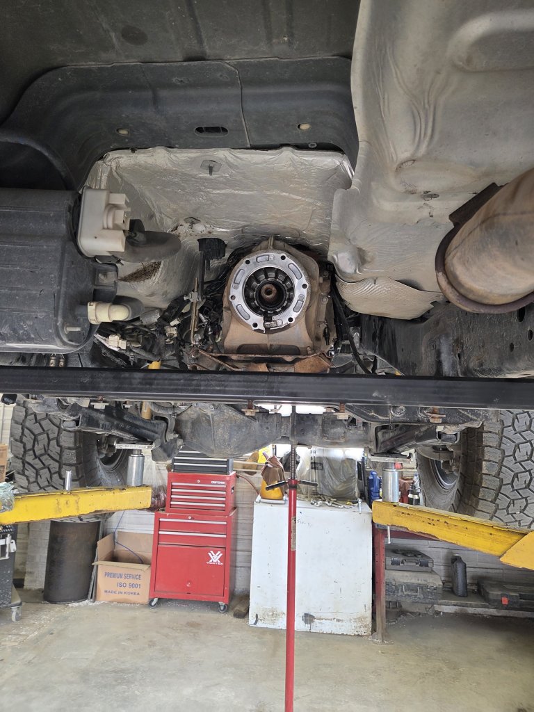

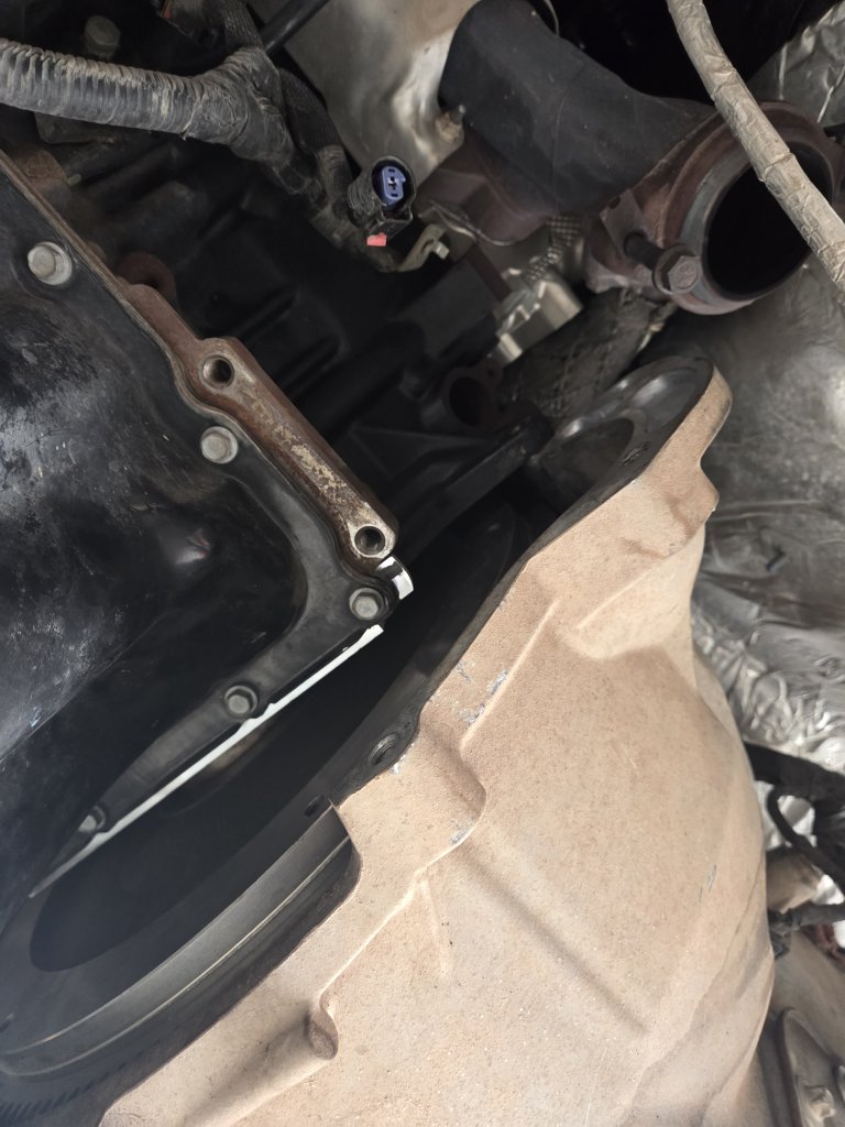

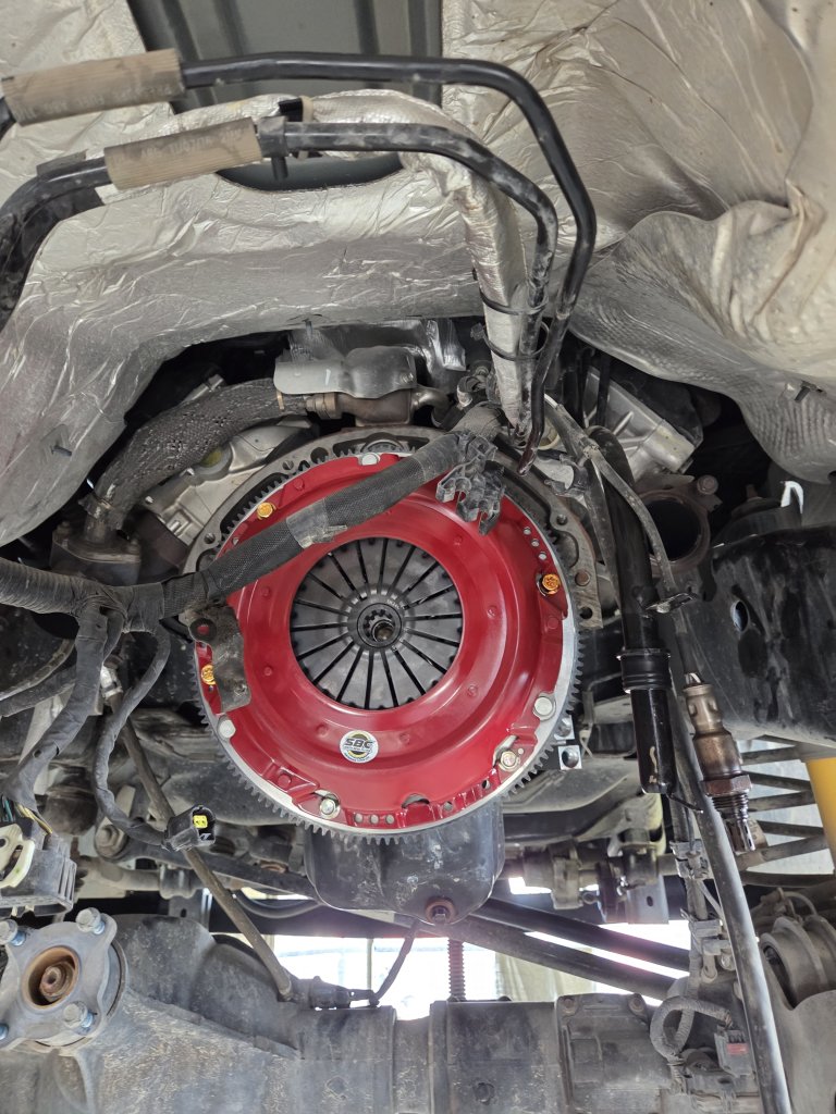

Will the BGE stock auto crank accept a pilot bushing/bearing from the factory?

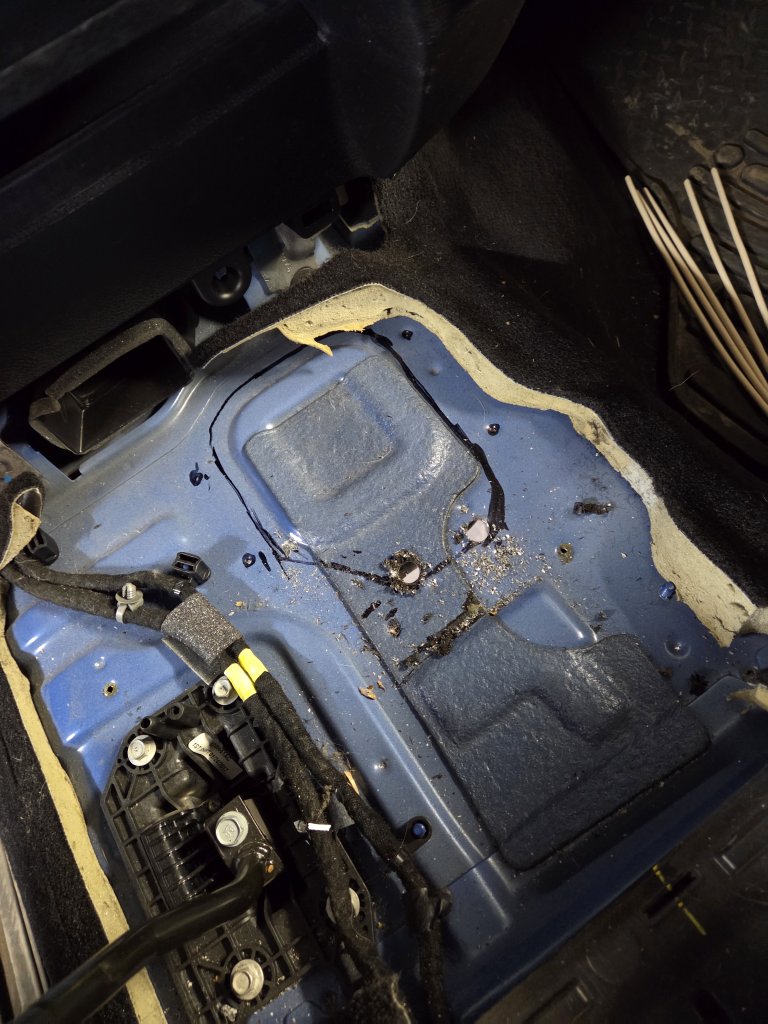

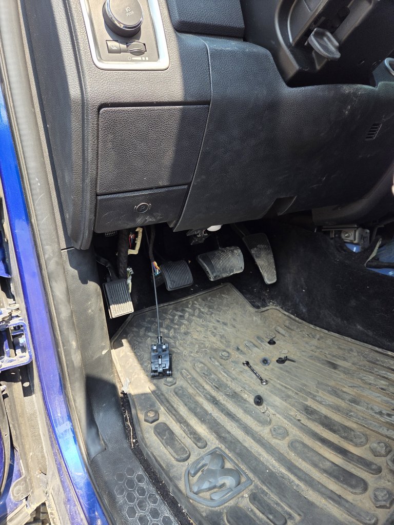

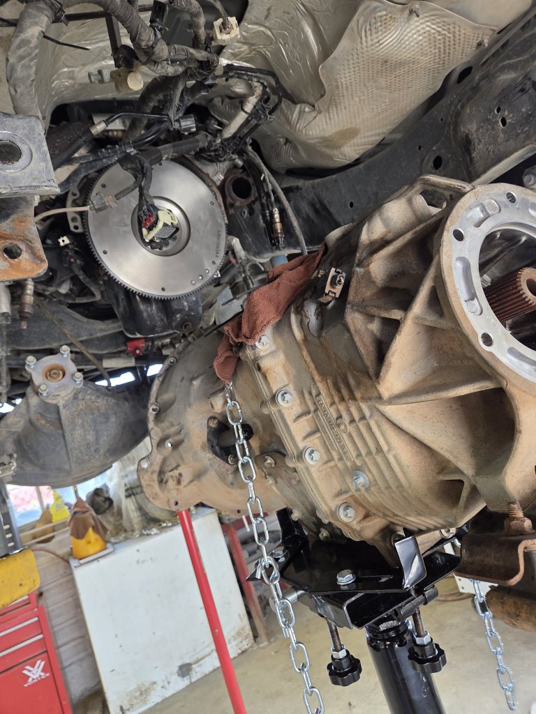

I will find out this weekend. Sure looks like it will from looking at it. This weekend is the install phase. Test fitting a bunch and all that. First I will change out my rear main for cheap insurance, then throw the flywheel up there. I'll toss the g56 up there and see what it tells me. Measurement wise, the bellhousing is the same. Should honestly bolt in no problem. Then the cutting the floor part. That is going to be a slow process. Don't want to mess that up. I will post updates here as I get going.

I don't have any experience working with transmissions, and I don't have access to a lift. It wasn't easy to find a mechanic that will take on the job. If you want to do a swap like this and cannot do it yourself, your best bet is indie Mexican mechanics! So far, only the Mexican mechanics I talked to would say it's doable. These shops are one man, cash only, and they do not show up as auto repair shops on GMaps. They don't even have names. The first guy that gave me the sky high quote was the brother of the (also Mexican) mechanic I usually work with - and that shop is also a shady cash-only garage, but he does some amazing jobs. The second shop - the one I have decided to work with for this swap, I met the guy at an auto parts shop.

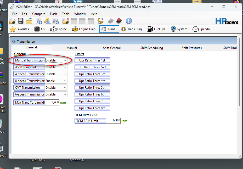

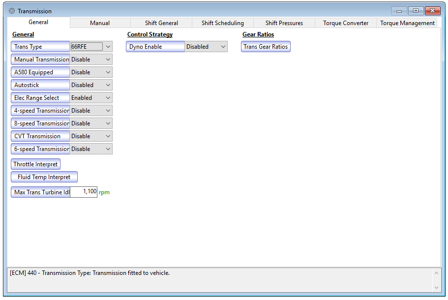

Right off the bat, I see at least 6 items that may need to be changed going from an 8 speed to a manual
I am not familiar with the programming, but my '16 8 speed shows this

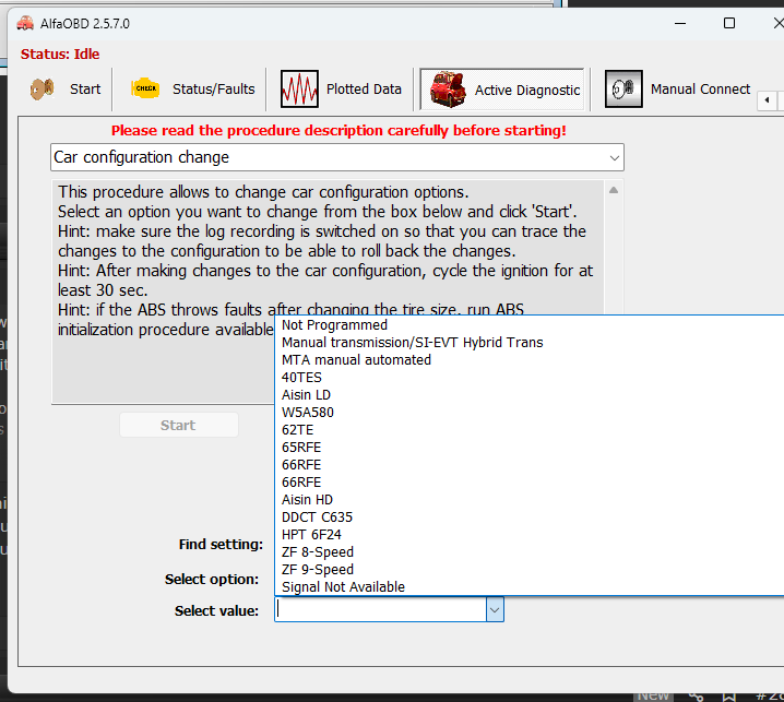

I took a look at a sample tuning file from a '15 2500 with the 6.4. Available options for "trans type" are: 40TE/41TE/41TEA, 42RLE, 545RFE/65RFE, 62TE and 66RFE. This is not looking good - I don't see a manual option here. I assume they stopped using the "manual transmission" vs "8-speed transmission" to differentiate between models and switched to the more specific "trans type".
I have not yet bought the tuning tools and software so can't test this out. Maybe OP can confirm if the '17 6.4 uses the same format, and if toggling "manual transmission" here can fix engine error codes when the 66RFE sensors are gone?

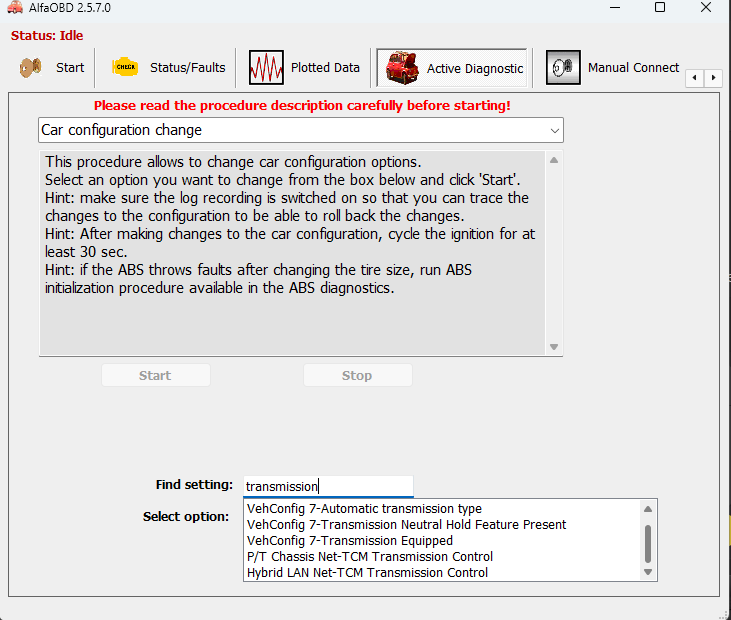

Under Engine > Fuel > Lean / Fuel-Saving there is the option to disable MDS so that should not be an issue. Everything else seems doable with AlfaOBD. The "trans type" issue looks like the last missing piece to me.
