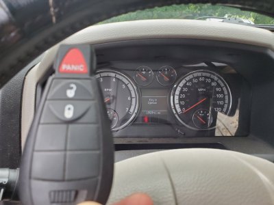

The other day i was going down a bumpy road and the red light came on for the alarm. I pulled over and shut off, after this it would not start back up.
Lock and Unlock does not work on my fob.
I took key out and it was stating key was still in ignition when i opened the door.
I tried unplugging the battery for a couple hours this did not help.
Now it no longer says key is in ignition and nothing happens when i try to start i hear a click coming from under the dashboard almost sounds like it might be coming from the cluster but nothing happens.
If i open the door it shows me the current mileage on the truck.

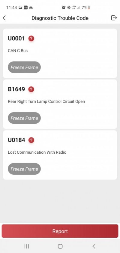

Checked codes this morning as nothing appears to be working i have tried everything i could think of.
I am getting a code u0001 Control Area Network C Bus
Im not sure if this is because i unhooked the battery over night, I cleared codes i had some that stated my headlights and foglamps were open or high also.

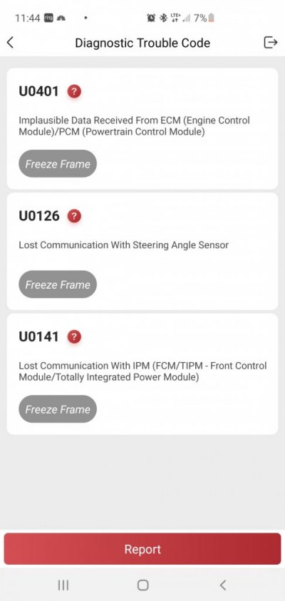

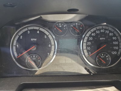

Ok update, since my last post i changed the win module (ignition) and the PCM it drove without issues for a week or so while it was cooler and 3 days ago it was hot and it once again tripped my immobilizer light while driving and i parked it shut it off and now nothing when i turn the key and i can not even read codes. I get slight acknowledgment from the TIPM when trying to read codes but nothing else. I am lost i have checked all my grounds, looked for wiring issues. I dont know what would send the whole system to sleep like this. I even tried the old ignition and old pcm since clearly those were not the problem. What could cause the whole system to go to sleep like this?
If i open my door i can see my mileage. If i turn the headlights on it will tell me they are on. But nothing else, i cant even hit lock and unlock on the doors nothing happens. Battery is fully charged, horn works. I can turn the hazards on.
Please anyone. I am so lost. I know its something with the Can Bus C because i check the codes regularly before it shut off again and frequently get U0001 but i can clear it.
Im not sure which module i should try next or anything else i could try. Or anyway to wake the system up.
