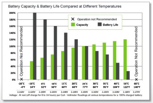

In cold states a lot of stuff happens when it's cold regardless of what the battery tests at. Has something to do with capacity versus charge in the cold. You have great battery life but capacity goes to hell in the cold, see below. But, if you are dead crank this likely isnt the issue, the ignition might be. Now that I read your post a second time it might be battery, monday morning brain fog. Always the most likely culprit in cold start issues anyhow. chart explains it, not enough CCA.
