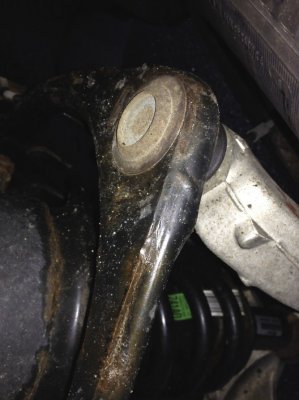

The UCA on my stock 2010 doesn't look like the pictures of the 13-14 UCA, they are different.
Here's a 2010...
Here's a 2010...
Wow. Looks like they have about 1/2 the thickness for the press fit ball joint. No wonder they are having problems.

I'll have to check, but I believe our (09-12) UCAs are hollow underneath the press fit, and not a full 1" thick
