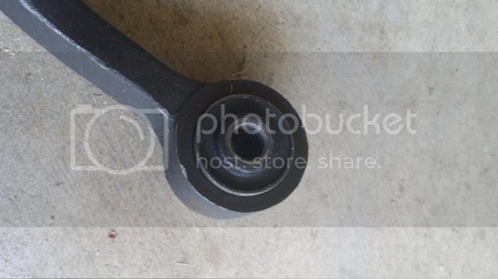

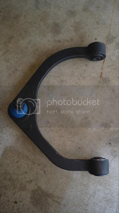

So I got the new Movotech UCAs yesterday and I think these are going to work great. They are solid all the way through, not hollow like the stock arms. I think this will be an excellent alternative to the expensive zone arms.

I have not installed them yet, still waiting on my Bilsteins to come in. Here are some pics though. I'll lay them next to the stock arms when they come off and compare ball joint range of motion between the two. I highly doubt these are going to pop ball joints like the stock arms.
