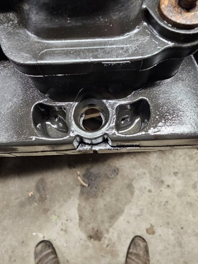

Pic of the fun I've been having with this project.

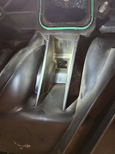

Found my problem(s)! Apparently plastic intake plenums really don't like combustion boom booms torching 5 holes through them. Three pinholes and two gaping breaches in the plenum from fire blowing back through the intake valve and melting the runner down. #5 is in rough shape to put it kindly, with 5 breaches in the runner. I suppose that would be the cause for my vacuum leak. I gobbed a bunch of grey rtv over the breaches,hoping it'll hold til I can source a brand used one that isn't burnt to all hell 1000002682.jpg1000002687.jpg1000002688.jpg
