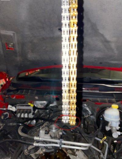

Update:
So, after some intense research and homework, I decided that I would start take a look at the timing chain and tensioner to see if this is what the issue could be. Note that my truck now has 160,000 miles on it at this time. After removing many items and getting the oil pan loose, I was able to remove the oil pump and cam phaser to remove the timing chain. I took a flat head screw driver and lined up both chains with the colored links and let them hang low. As you can see in the image below, the new one is a bit shorter than the original on the right. So my hopes are that the old timing chain is definitely stretch and this is why I am getting the P0016 code.
After I get the timing lined up, new parts in, and everything re-installed, I will give an update if this fixed my issue.
Also, would you guys advise getting a new water pump as well?

If you have not already, pull the intake manifold and remove the VCT Solenoid and inspect it. My educated guess is that the screen is missing and it has come apart.
A stretched timing chain and a worn tensioner can cause P0016 and in conjunction with a damaged VCT Solenoid it can and will cause P0016.
Also, if the water pump was operating like normal before you took the timing cover off I would install a new seal and reuse the pump without hesitation.

What was the actual code you were getting? As posted above a failing oil control valve for the VCT can cause timing issues and is common for a 2012.

P0016 is most likely the VCT solenoid, it's at the front of the engine under the intake manifold infront of 2 mds solenoids.

Thanks guys, I already replaced the VCY before hand and the code still came back, that is why I decided to dig in and replace the timing chain. I used to haul a bass boat around with the truck and at 160,000 it was time to replace the chain for sure.
Now I am having a hard time finding a "Long Reach" Harmonic Balancer Install kit, it seems difficult to find tools in small towns haha.
