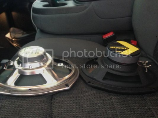

I installed kicker 3½ in the dash and 6x9 in the rear doors. I ordered a set of 6x9 for the front but they were to deep so I have to reorder a set or kicker 6½.
