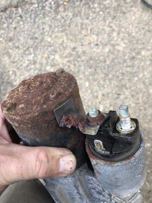

Thanks for all of the advice guys. It ended up being the starter. The wire coming out of the starter and to the solenoid was corroded almost in half. I replace the starter and it started right up.
Glad you got it fixed! I guess you do a lot of saltwater fishing or live near the ocean because that looks like saltwater corrosion to me.
Yea i would be worried about the underside of the truck you should coat it with something so it doesn't rot out.

Same exact thing happened to my starter. Went to the mall, came out 30 mins later truck wouldn't crank. Was fun changing it out in the parking lot in November, lol.
I get my truck undercoated but I guess it didn't make it to the starter as it's in a tough spot so I was sure to pack the new one with dielectric.
