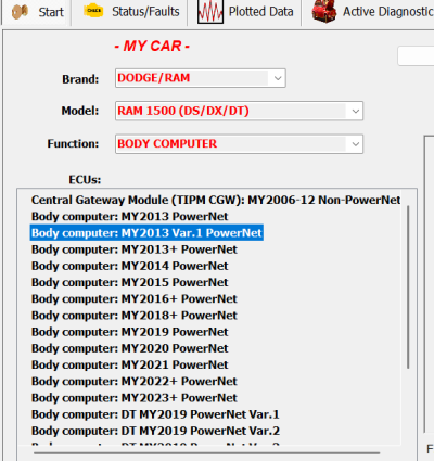

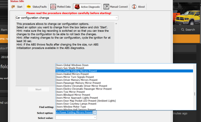

Or, you installed a set that you purchased somewhere and are trying to activate them in the BCM? If that is the case, you need to connect to your trucks BCM with AlfaOBD, then go to "car configuration change", and select the following option:
First, connect to the BCM (Body Computer):
The select "Car Configuration Change" and "Doors-Power Folding Mirrors Present".
You'll probably also want to activate any other options that your mirrors have, like heat, turn signals, etc.
