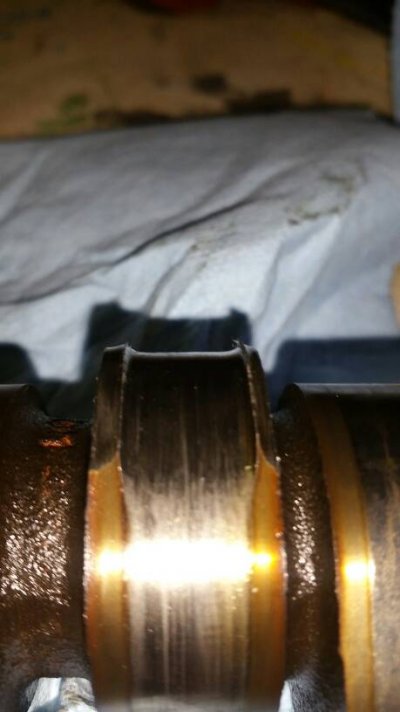

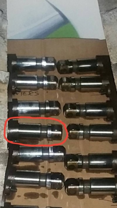

A motor I picked up cheap had a misfire on cylinder 6... rocker arm did the same thing and was slightly chipped... no broken valve spring and rods were all straight.... we pulled head the lifter was seized and cam had a nice grind into it
Also this wasn't an MDS motor it came out of a 2500 but ya that's probably what ur gunna be looking at 9c0947717c745f09df766bcd0c00cfb8.jpg57a3eb439791db1afd06fe4ffed70cf8.jpg
