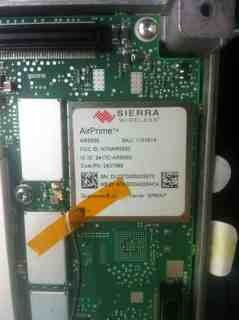

Ok so I did some tests and also opened the radio. It's the damn Sierra 3G card inside the head unit that's sucking up the battery. It must be trying to update since the Uconnect upgrade went awry! Pics below show milliamp draw when I disconnect the head unit then back up to over 3A when connected. I even made sure to wait for the truck to go to sleep etc.

In my case it was due to the update, it doesn't seem that it was the 3G link but it was definitely due to the radio, the radio wasn't going to sleep for one reason or another and it would cause the evic to light up etc and drain the battery. They flashed the radio with the latest software and that fixed the dead battery.
Flashing the radio also messed up my Uconnect subscription so in the end they had to put in a completely new radio. Good to go.
