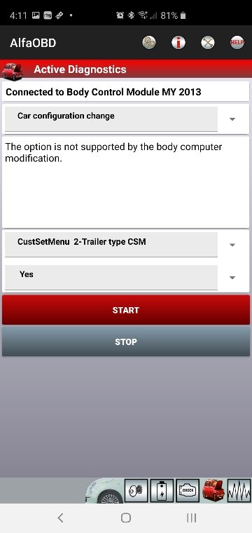

i purchased the factory controller and switch, installed and hooked everything up, but alpha obd keeps telling me its not available in my module?
has anyone run into this issue?

Tried again after new radio install same results?8a9a204b24b3e753e6b76e1e2d884905.jpgd3b1f05a20964e07d1e1e5bd4d22aad4.jpg

Figured it out!!! if anyone is interested? trailer brake control is operational.

On the 1500, we dont use the 3 cmc settings, they are for the 2500 3500.
( ITBM Integrated Trailer Brake Module: Not set) <<< this is the setting to turn on in the 1500.
Its in car configuration change, just closer to the end of the parameters.

I know this is a bit late, but are you referring to the "P/T Chassis Net: ITBM/HWM Integrated Trailer Brake Module" setting?
