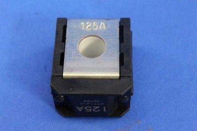

There should be a 100 or 125 amp fuse bolted practically right to the positive battery terminal for the power steering, It's a Z-Case fuse(see pic)
The other fuse I think is F78

Uses fusible links (but confirm, do not take my word on it).
But I am no mechanic. I had the Zcase's on my ED, the 5.7 are a lil different. There are no Z-Case attached to positive cable at battery. One goes direct to Master Fuse case and another branches off somewhere down towards electric power steering unit, Cannot see where,.

It was not either Fuse so most likely the rack will need to be replaced unless it is an issue with the U joint on the steering linkage. Thank you for your assistance and thoughts. I am able to turn the wheel even at a stop but as we have a farm and the wife won't haul hay in her Kia I will have to get it fixed so it is safe for all to drive. My then 5-year-old Grandson saw the truck and said to my wife who he calls G Paw Paw has to have this truck. His thought is one-day Paw Paw will give it to me.
