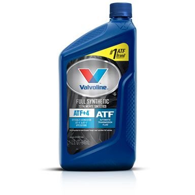

What are your thoughts about using,valvoline max life full synthetic at in my truck when it comes time to change it?

Use whatever atf4 you like, but it needs to be atf, the maxlife multiuse had a viscosity to thin for the rfe. Look at a stat sheet, the operating viscosity should be in the 7's.

Awesome! Great info, thanks brother!
