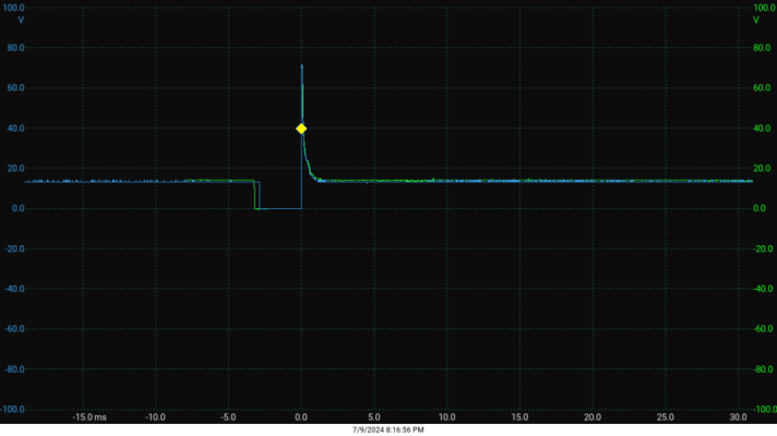

Hello,
I am trying to help my brother diagnose a cylinder 2 misfire on his 2014 Ram 1500 3.6L. He has already replace the ignition coil on that cylinder with no improvement. I checked the number 2 injector with my PicoScope and it shows a good waveform except that it is about .365 ms shorter duration than the number 4 injector at idle. The misfire is on cylinder 2, cylinder 4 has no misfire. Is it normal to have a slight variation like that between injectors? I have attached an image of the two waveforms. The green trace is the good cylinder 4.
Thanks

40
Thanks for the info. I am aware of the cylinder head issue on this year truck. I was hoping to find out it was something less serious than that, but it is looking more like it could be the head issue so I will do the compression test. Thanks for the injector information also. I'll check the ohms on the number 2 injector

2021 2500
Swap the 4 and 2 Injector, easiest way to see if that is the issue. Have you run a fuel line cleaner and have you checked to make sure the plug and plug wire on 2 are both good, as they will also cause a missfire?

Do you know the details on the failure? I've seen a lot of folks complaining of Head Gasket Failure on the Pacifica forums. Was this a warped head or a failed gasket? Do you know which cylinder?
The problem from the factory was the #2 cylinder valve seat would overheat and warp, burn the valve, or the seat would come loose.
Checking the compression and comparing that to the other two cylinders on that head will give you an answer.
